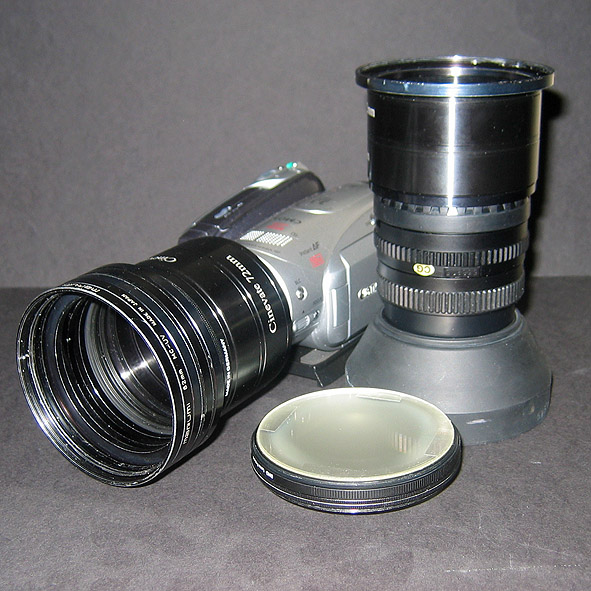

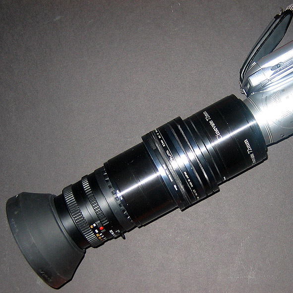

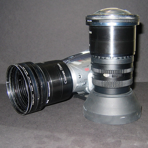

Looks not beautifully, but it is a project version
Svyatoslav Pylypchuk is offline   Reply With Quote
