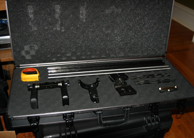

I keep a set of 12" rails on the camera, and mount the longer ones as needed.
I store the longer rails in a Guide Series breakdown shotgun case I picked up at a sporting goods store.
Rails / Rods for Letus Extreme?-rails.jpg

Shotgun case...? Until I saw the picture I was visualizing in my head what a joy it would be to get through airport security with a shotgun case and rods inside the case....
"The only thing the camera sees is light..."
http://www.GoWildOlive.com
Doug Davis is offline   Reply With Quote
Old October 10th, 2007, 06:54 AM   #8
Location: Little Rock
Posts: 1,383
It was low cost, and It didn't need to be water proof.
You can always put the rods in the case with your camera.
But just be aware, that if you have rods that are 24" long,
the interior of the case will need to be at least 24" long.
