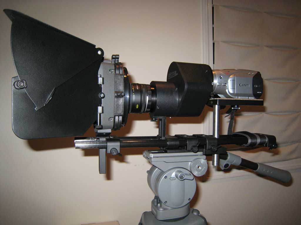

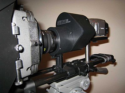

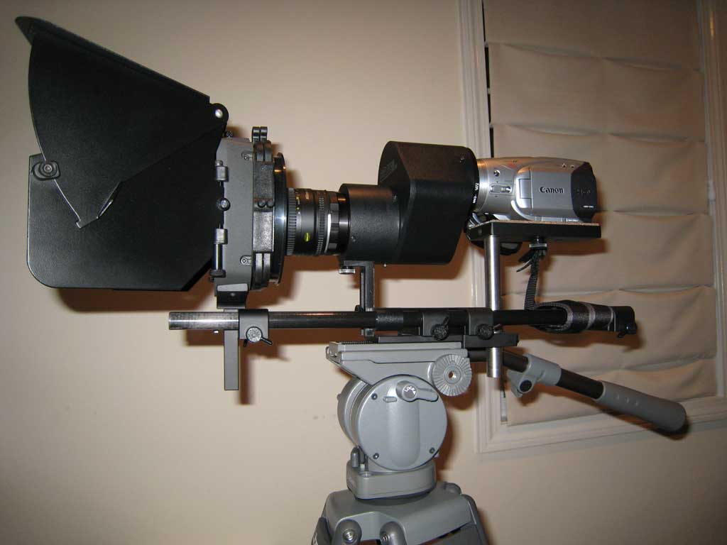

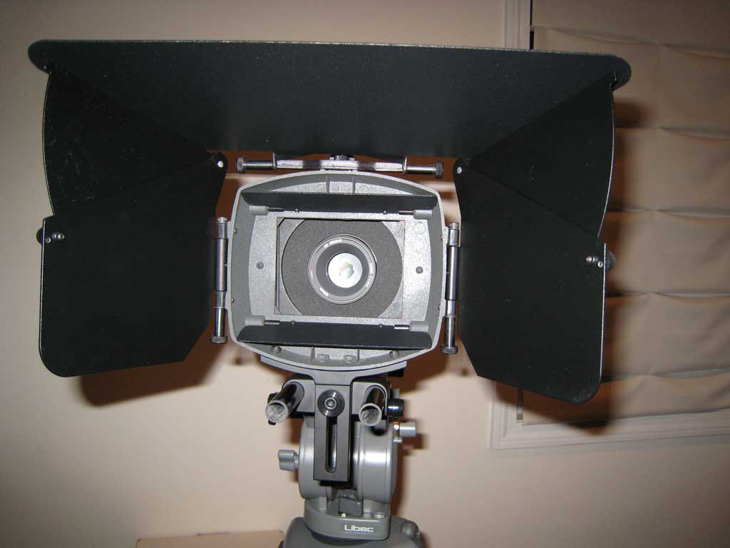

Finally got the rig setup:
HV20
Letus Extreme
Cinevate 45mm carbon rails
Cinevate Mattebox
Libec LS-55 tripod
I was able to mount everything perfectly level and balanced; no front or rear heaviness at all.
Next up: Test footage...

What have you used to raise the HV20 so high?

I think he just change the 5/8 rod to a longer one instead of the standard 5/8 rod that comes with the Cinevate rail set.

Hi Phil,
David is correct... Dennis Wood of Cinevate gave me a 6 inch post in addition to the standard 3 1/4 inch post for the camera baseplate. The post is actually 5/8 inch tubing you can buy at most hardware stores.
I knew I would need a longer post in order to raise everything high enough to fit into the mattebox at its lowest height so I just asked him to include it with my rails and mattebox.

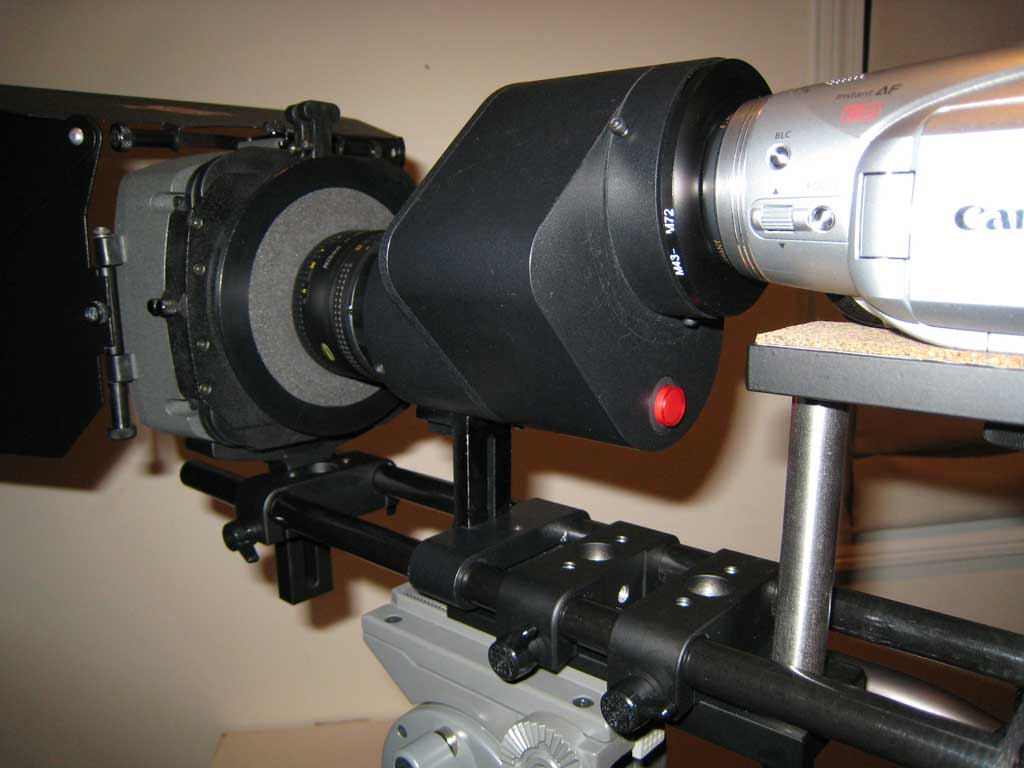

Hi Leo, where did you get the step down ring to fit the hv20? BH?
Alex Ponce de Leon is offline   Reply With Quote
Old June 22nd, 2008, 10:33 PM   #6
Location: Wichita, KS
Posts: 52
If you have a 72mm ring on the Extreme, you can use a pair of step rings to make the jump to the HV20/HV30 43mm threads.
52mm to 72mm ring
and
43mm to 52mm ring
That's what I use and they work great.
