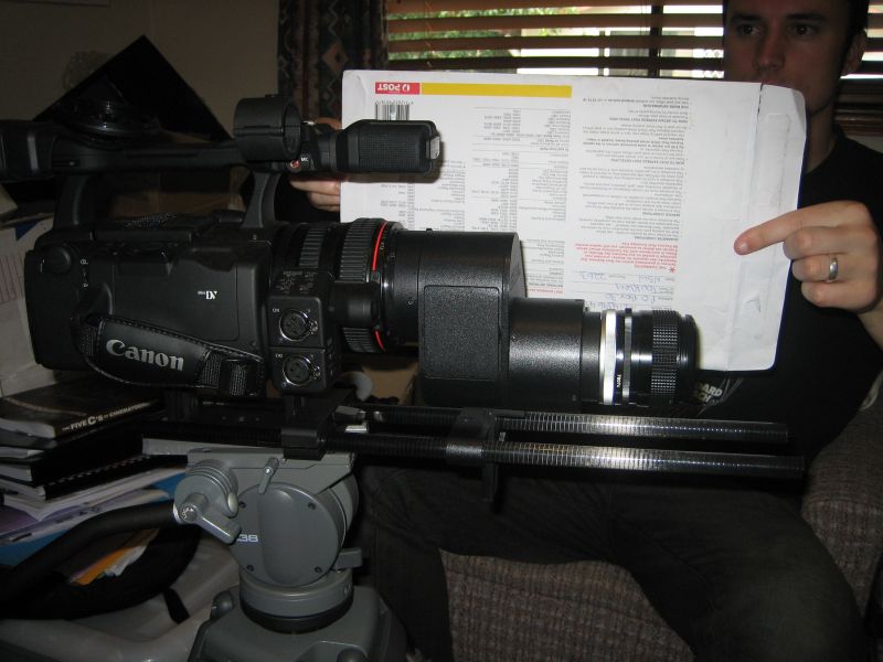

I got rails & follow focus from
http://www.indifocus.com/
looked like the best value to me - with the weight of the Extreme and a lens, I wouldn't be game to go without rails. They are the 18" ones which should give me plenty of room for a long lens and a matte box.
yes there is something missing - I got the wrong adaptor, the correct mount is a couple of days away
Cheers - Paul M.

So what's wrong with the rails pictured above?
Steve Yager is offline   Reply With Quote
It is very heavy on the front side. , If you are not using a counter balanced tripod that can take that weight. Not the max weight that the tripod can take but the max counter weight it can take. You are risking it tilting forward. and it will also wear out the head of the tripod if you have it tilting all the time.
If the base plate is separate, you can adjust the position of the camera , adapter, matte-box , follow focus unit and lens forward and backwards along the rails and balance it.

Old November 21st, 2007, 02:57 AM   #7
Posts: 1,620
I can do all of those things -the balance is fine - I assume you have actually tried the rails in question? or are you making an assumption based on the picture?

Old November 21st, 2007, 03:09 AM   #8
Location: Singapore
Posts: 427
I have cavision rails and has the same concept as the indie rails . they are fixed to the camera. I also tried the Cinevate rails and you can adjust the position of the whole rig back and forward which niether the cavision or indie rails allows to do so. Even the more expensive Zacuto rails need to have a counter balance lunch box fitted at the back to balance the whole rig.
Not everybody out there has a long tripod plate to allow balancing. What about those who use a manfrotto 503 or 501HDV or tripod with out long enough plates

Old November 21st, 2007, 06:09 AM   #10
Location: Singapore
Posts: 427
... the 38 head is great, very happy with the whole thing
You can't do those things because the base plate is fix to the tripod and the camera sits above it. you can only adjust the length of your rods , but you can't adjust the position of your camera. The Camera is always siting on the base plate which is above the tripod.
Go here and see this design from Hien and you will know what I mean.
http://www.dvxuser.com/V6/attachment...1&d=1195001681
And here for the XHA1 with Cinevate rails:
http://www.dvxuser.com/V6/showpost.p...2&postcount=29
You will notice that both system here has the camera away from the base plate. Which is what I meant. Which neither your rails or mine can do.

Old November 21st, 2007, 05:28 PM   #11
Posts: 1,620
I think I understand your point (I couldn't see the first image )
I've been adjusting the balence by moving the quick release plate back before locking it in place.
When I get the FD mount (any day now) I'll set the whole thing up and take some pictures.

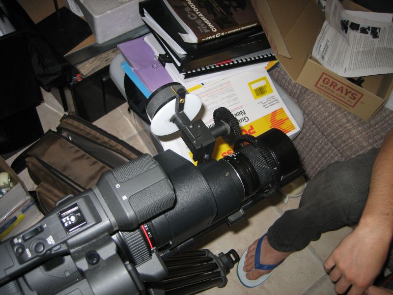

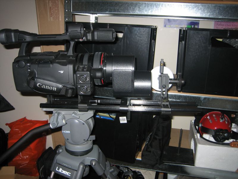

Old November 25th, 2007, 05:54 AM   #13
Posts: 1,620
Originally Posted by Tim Ovel View Post
To purchasers of the indiRAILSpro that would like the new mount peice, we will send them out, no charge, just drop us a line with the address.
sounds good to me, the balance isn't a problem at the moment but I love getting free stuff :-)
Just bought the Letus Extreme...-card-385.jpg   Just bought the Letus Extreme...-card-387.jpg
