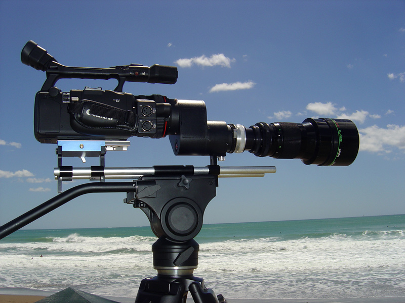

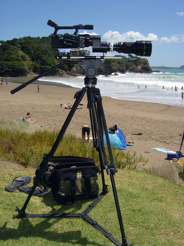

I just purchased an FD S.S.C. f2.8 300mm. Took it for a test run today at the local surf beach.
It came with a 2 x extender. I'm very happy with the results, but I will need to get a mounting support for it.

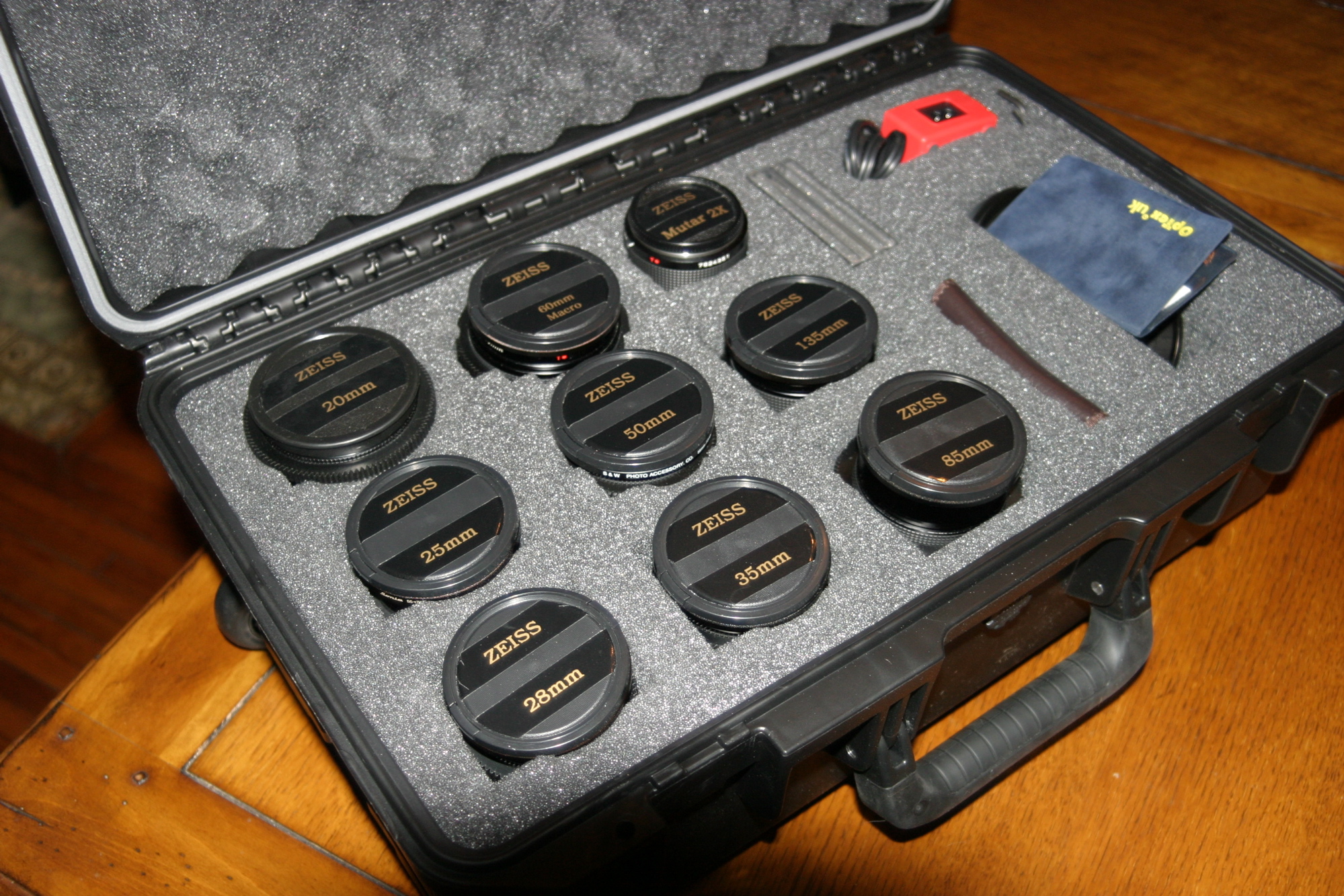

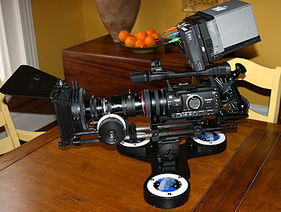

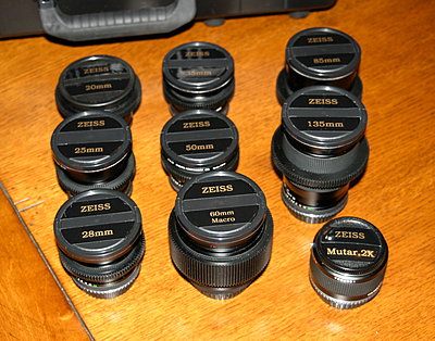

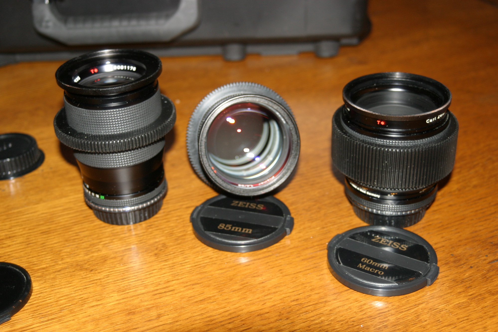

While both Nikon and Canon make great lenses, be aware that there are a good number of Nikon and Canon lenses that are a poor choice when it comes to use with a 35mm DOF adapter.
Also be aware that your choices are far from being limited to just Nikon or Canon FD mount.
As Ray pointed out, Zeiss makes some outstanding glass.
As well as owning Nikon, Canon FD, Canon EOS, Pentax and others,
my main choice for work are Zeiss Contax lenses.
Purchased used, they are less expensive than the new Zeiss ZF lenses.
They also focus in the same direction as cine lenses, while the ZF lenses focus backwards like all Nikon lenses do. They come with a Contax-Yashica, or C/Y mount, but slap on a C/Y to Canon EOS mount and you can use them with any camera that has an EOS lens mount.
They are a great choice for lower budget projects that don't require renting Zeiss Super Speed PL mount lenses.

David,
Mind if I ask where you got the gears for your lenses? Hope I'm not hijacking the thread. Thanks!
Min Lee is offline   Reply With Quote
Old January 29th, 2008, 05:40 PM   #8
Location: Little Rock
Posts: 1,383
Originally Posted by Min Lee View Post
David,
Stuart at Focus Optics.
