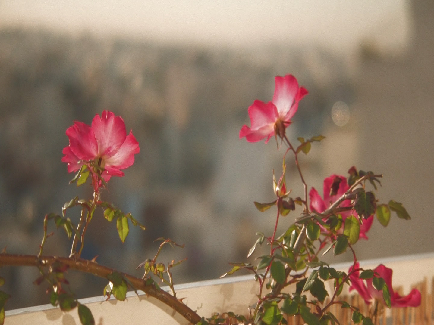

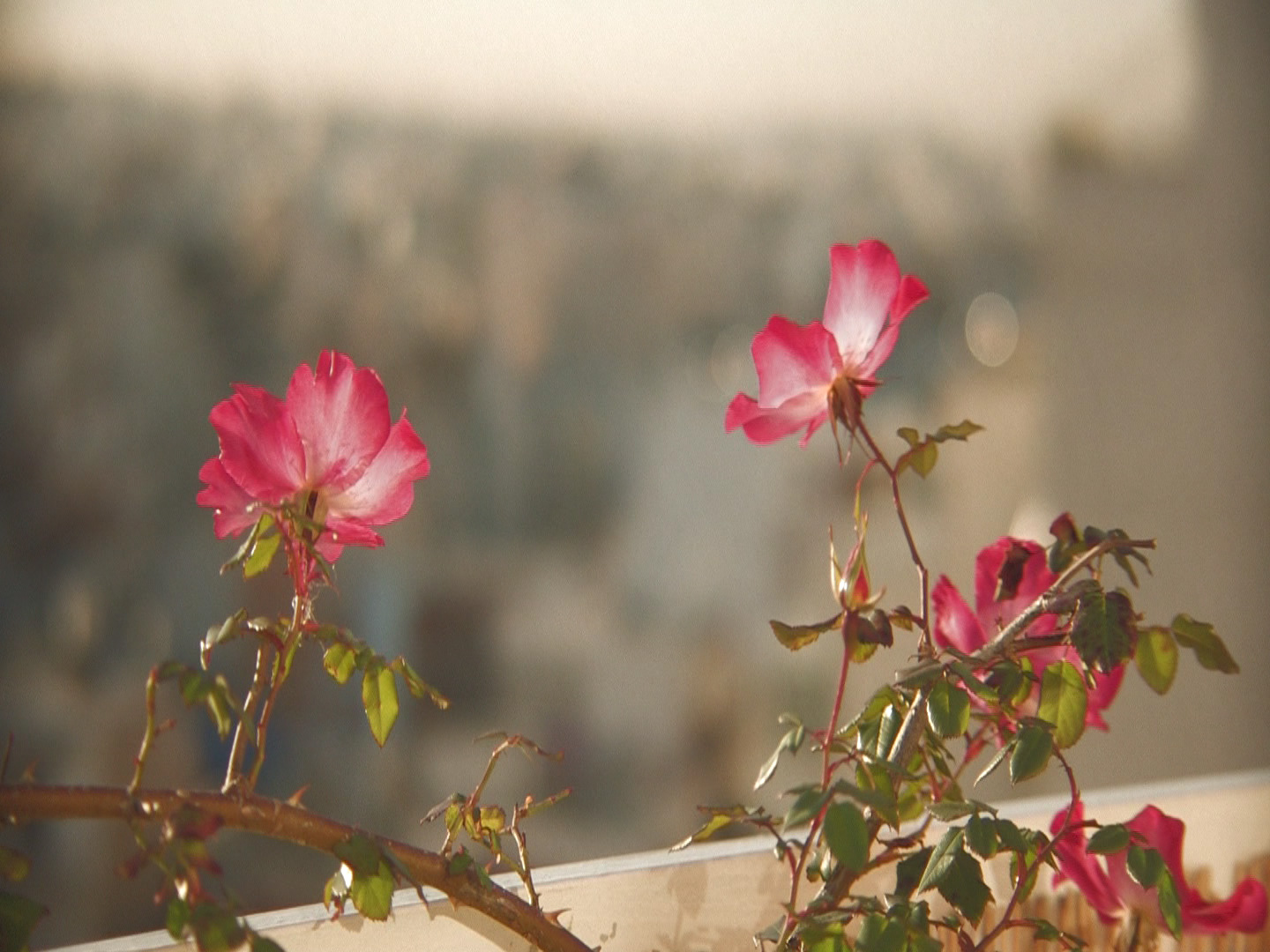

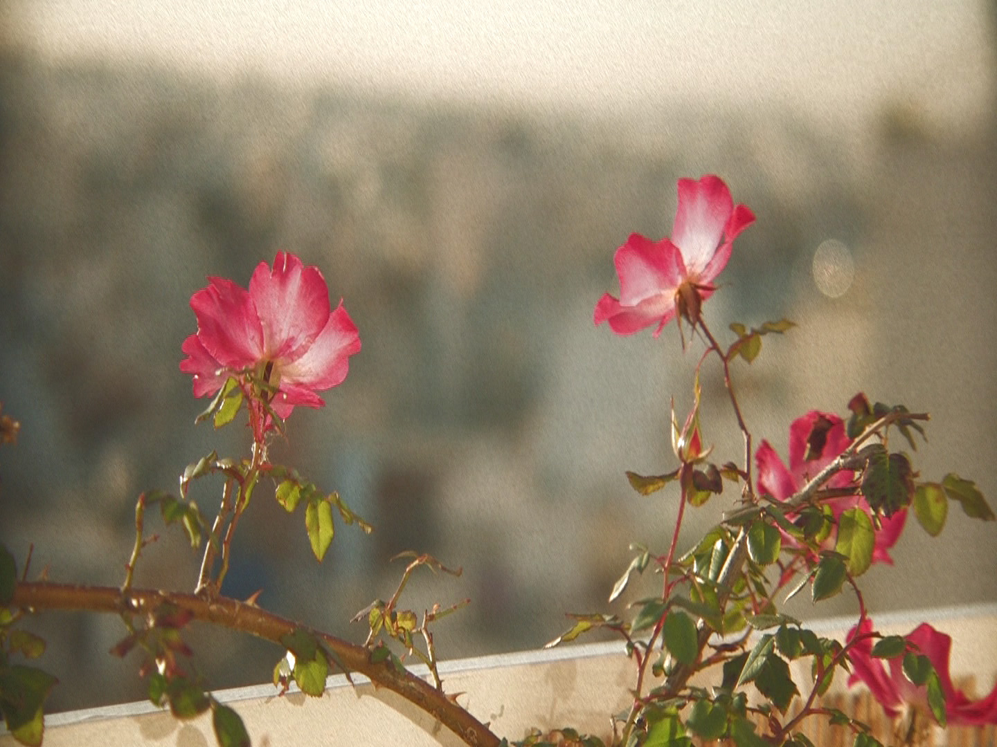

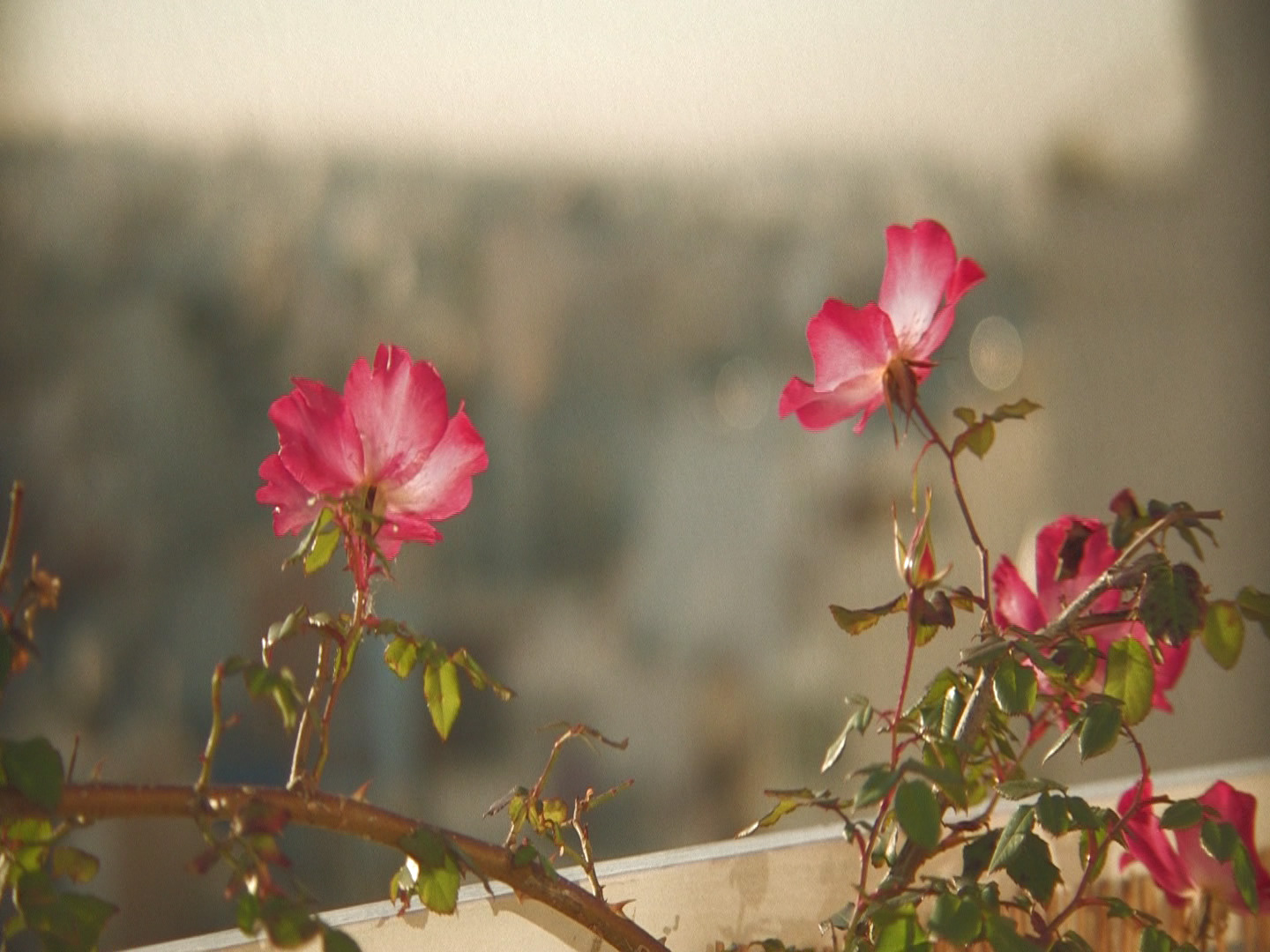

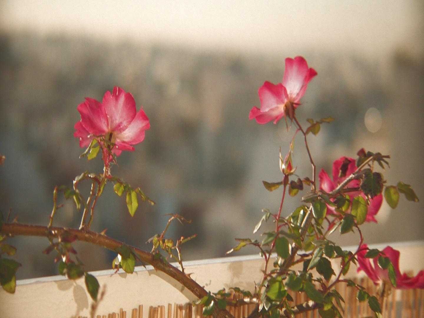

Ok, here goes.
I shot some flowers with varying ND, F stop and shutter trying to get the same exposure. I didn't use a monitor or waveform to judge accurately, but I think the results are obvious.
So, if you step down the camera using ONLY the shutter speed, with iris wide open and Shutter at 1/25, then the ground glass can be clearly seen on brightly lit areas.
If you step down using ND and/or F stop, the image looks clearer.
I believe that using the highest possible F stop on camera, then the image will be clearer, and this makes sense if you consider that you increase the depth of field this way, so the ground glass is sharply focused, as opposed to having an open iris and a more shallow depth of field.
Of course this is not a scientific test, as no scientific instruments were used, nor was a scientist present. And we all know that these are though times for scientists with 2012 approaching and all.

What were the settings for the last picture you posted? I'm seeing an artifact on the out of focus light in the background there not seen in the other photos -- like you can kind of see the pin of light through the bokeh. There's documentation of this artifact elsewhere, but you seem to be avoiding it in all the other photos.
Do you remember what settings you had for each photo?

Brandon, if you roll over with your mouse you can see the settings for each photo.
Stathis Athanasiou is offline   Reply With Quote
Old January 23rd, 2008, 05:50 PM   #23
Location: Athens, Hellas
Posts: 73
no ND
F 9.5
S 1/50
I haven't noticed it until now.
What is it? Is it random?

Well, I can't find the other thread, now, but YAY! I actually don't have the Letus Extreme yet (should be here soon), and this artifact was a concern for me till now. It looks like the camera iris needs to be kept fairly open, or else somehow the bokeh is slightly see through. Makes no sense to me, but it is a great relief to know how to work around it.
Bummer about having to keep the camera open, though, because that means it'll be harder to focus on the ground glass (I'd think).

From what I see from the pictures I posted, using ND and having the iris wide open, produces a sharply focused ground glass that doesn't show through.
To my eyes the sharpest picture is the one with ND1/32 f2.4 S1/25
