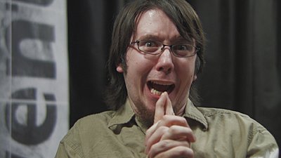

I've attached a picture that I posted on a local filmmaking site taken with my XH-A1 and the Letus Extreme. (Forgive the expression -- this always happens when I get in front of a camera.)
One of the more knowledgeable folks there said he saw Chromatic Aberrations, but only having experienced my Canon XH-A1's own unique CA, I cannot see them. I was wondering if anyone here could identify them for me so I can know what to look for -- not seeing any green or purple color fringing. Does CA have other looks?

Originally Posted by Brandon Freeman View Post
Chromatic Aberrations...I was wondering if anyone here could identify them for me
The green fringe on the right side of the banner with "e n" on it and purple fringe on the black letters ("e n") and white spot in the bottom right. It's certainly not enough to bother most viewers; I've seen much worse in broadcast television.
Yes. A variety of colors (including red) in high-contrast areas. C.A. also includes the overall color cast of the lens (and sensor), many are slightly yellow and red, but that may be corrected in-camera or with post-processing.

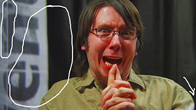

Brandon,
CA can also come in yellow and blue aside from green and magenta.
In your sample, as it is, its not distracting. But to clearly know what your looking for i boosted saturation. Tho you wouldnt be pushing it this way its just to show you where it is.
its usually found around the sides and usually appears in areas of high contrast. like black and white.
Ive attached the image showing you where they are.
I hope this helps you.
Ted

Brandon, I've seen much worse CA from other adapters and stock attached lenses - I think the image is completely satisfactory. The quality of the image is there, and it'd be subjective at this point - the average person, even he or she had the concept of CA described to them, probably wouldn't spot it here. Cheers!

The CA appears to be not a circular pattern but uniformly apparent from top to bottom of the image. This would suggest it may be a normal camcorder imager artifact. It is not lens related.
Ah. Then the A1 CA issues continue to haunt me. At least it's not nearly as bad as shooting wide with the stock lens.
