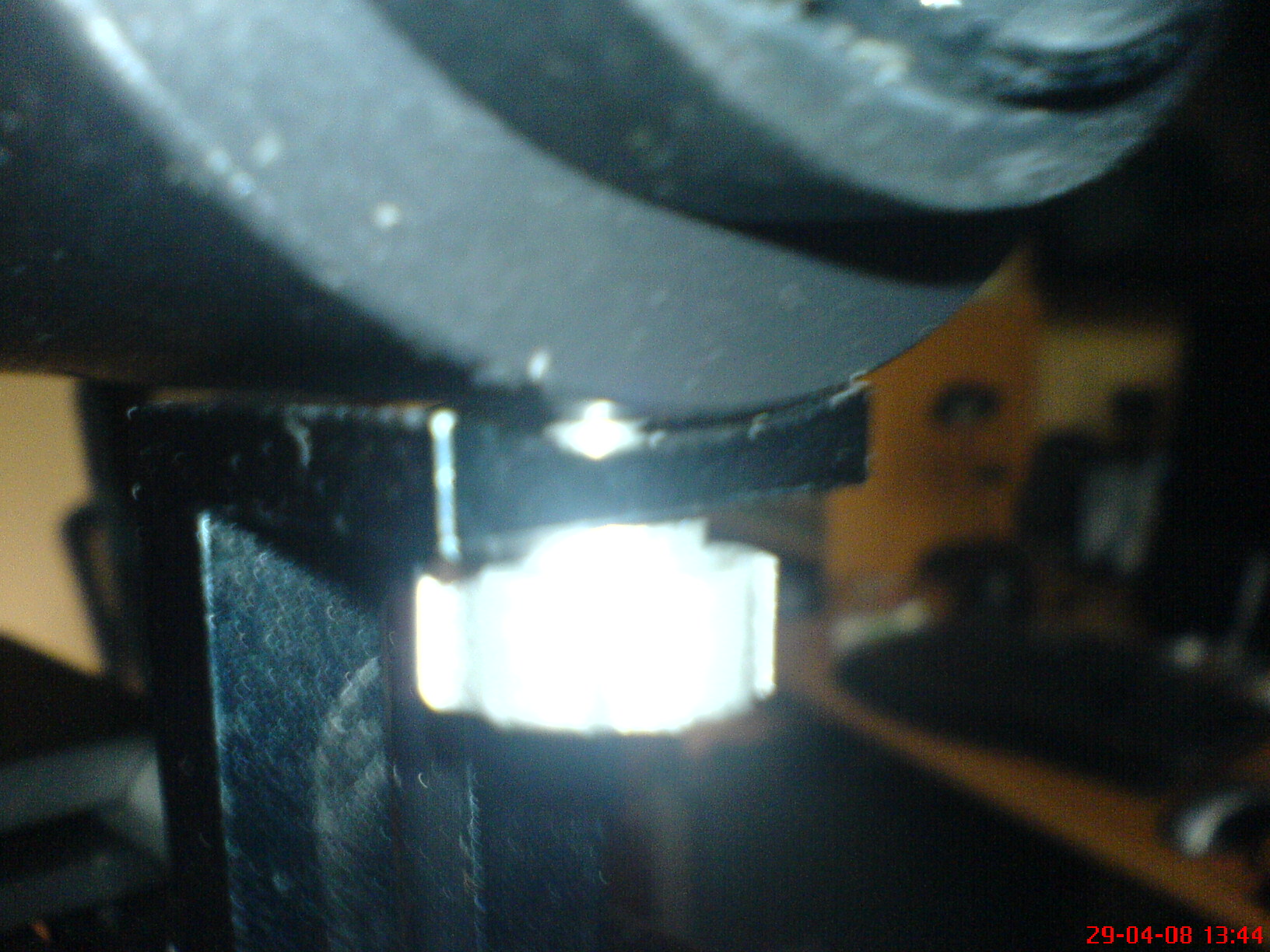

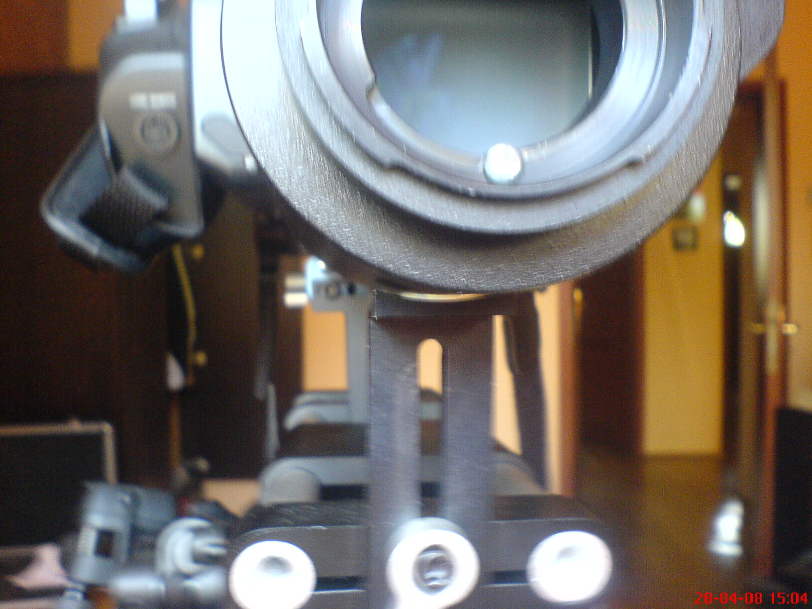

I have taken some pictures (with my mobile - sorry for the very poor quality; I was in haste), showing what happens to the front tube alignment with the front bracket after I turn the adapter on its thread ring in my EX1, so that the GG rectangle is level in the viefinder.
In spite of the poor pictures quality, it's obvious that - with the camera and the adapter on rails - I can either have the front bracket aligned and the screw tightened but the GG twisted as per the pictures I posted earlier in this thread, or have the GG level, but the front tube unable to rest on the bracket and the two connected with the screw.
I hope Aaron will address this obvious machining error...
