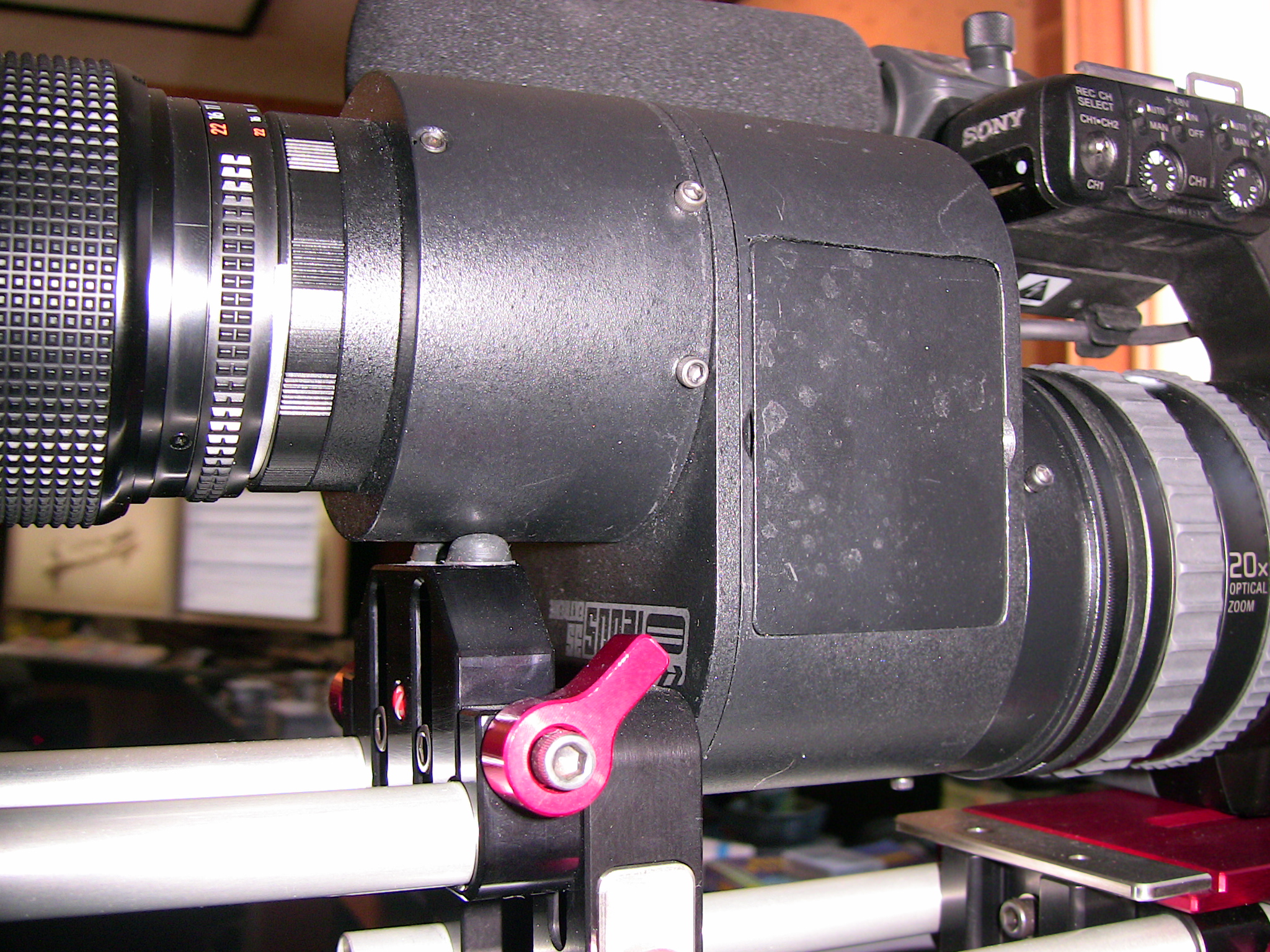

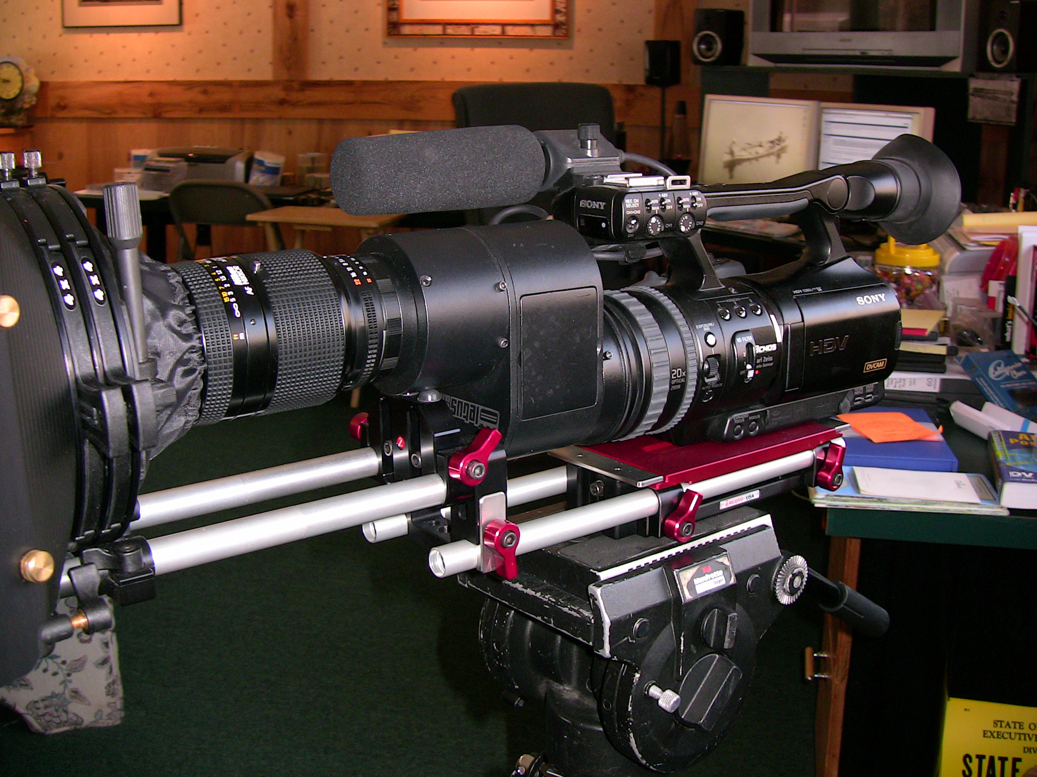

I guess it has to do with your rail system. The button I refer to is the big red one that turns the vibrating glass on and off. I'll attach a few pictures to show how mine is set up. Maybe it'll help? I'm not even using the bracket that came with the Letus Extreme, I use a couple rubber gromets and the Zacuto rails to hold it up. I see alot of people mount theirs the other way, with the red button down, but this is working for me. If I were to do it that way, I would have to raise the camera way up.
It is sort of complicated to set up. These adaptors are new and stem from a "cottage industry" of enthusiasts. It could be easier I suppose, but it could also cost even more.
