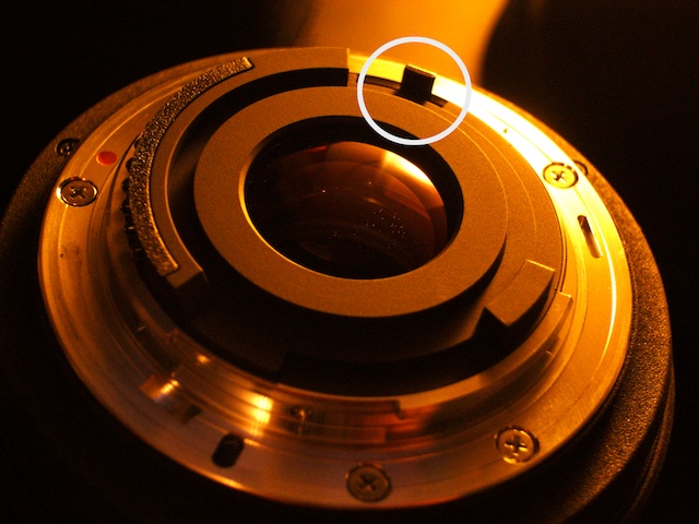

Hi Bob,
Is it a simple easy thing to do? Got dummy-proof pictures illustrating such?
I have a sigma ultra-wide digital lens (the 10-20mm zoom to be exact) for nikon. It would be fantastic if there was indeed an easy way to open and lock the aperture wide, and get it working with the adaptor, without damaging it.
Thanks in advance.

Took a pic of the 10-20.
There is a pin switch (circled in pic) that appears to open the aperture.

Kevin.
That is it. When you move the lever to the left as viewed from rear of lens it will leave a space. This space is where you put the wedge. For starters just try a piece of thin cereal pack cardboard rolled up tight, approximately 3/8" square. About two and a half folds will be about it.
Before you shove it in, just probe the space to find the depth first with something like an opened out paper clip. You may need to make that cardboard 1/2" x 3/8" but I doubt it will need to be bigger. The lever may creep back past a little but it should not matter.
I think you will find that your lens will vignette on the 10mm end but may widen as you zoom it in. I expect that your lens iris wide-open may be also in the ballpark of f3.5 to f4, going by the size of the rear element.
This may only give you about 1 f-stop of headroom before groundglass artifacts become apparent if they are not already there.
There are modern motion picture primes which go down to 9mm but they are hell expensive and also do not cover much larger an area on the groundglass than the digital lenses as they are designed for the 24mm wide motion picture flm frame.
On the Letus Extreme you may find you achieve just as much field-of-view coverage by using the 14mm f2.8 Nikon prime across a larger groundglass area.
This will yield fewer if any artifacts and sharper resolution through having less magnification of the groundglass, therefore smaller scaling of the groundglass texture relative to the image area seen by the camcorder.
