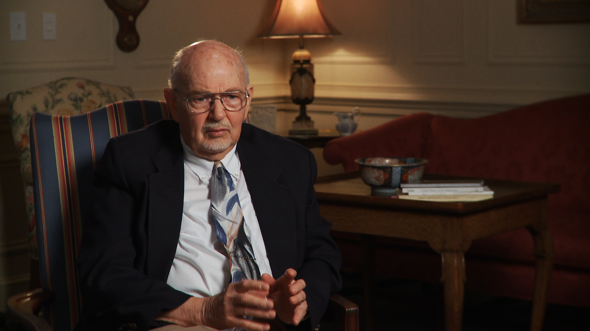

Followed Phil's advice and it worked well. Here's a frame grab straight from the camera. 50mm lens at 5.6.
Focusing under relatively low light with Extreme / EX1-int.png
