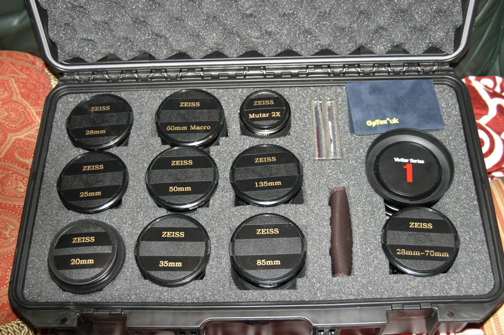

I use Zeiss C/Y lenses, and I must say that they are fantastic.
You might consider getting a Canon EF, aka EOS lens mount for your DOF adapter.
You could then use Nikon to EOS mount adapters on your Nikon lenses, and C/Y to EOS mount adapters on your Contax mount lenses. That way you would not need to ever change the lens mount on you DOF adapter to use a variety of different mount lenses.

wow.. nice box of tricks you have there! That 25mm keeps going up in value aye?

Really nice box david!!!!
Great idea with the mounts. i will follow that.

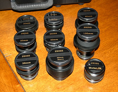

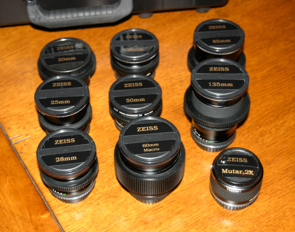

As far as lens mount, you want to use the C/Y, aka Contax Yashica mount for Contax 35mm SLR cameras.
The Contax N mount will not work. Nor will the Contax G.
The whole range of Zeiss C/Y mount glass is fantastic.
T* coated, color matched, great contrast, and they focus in the same direction as cine lenses. I have added like sized hard fronts so each lens fits my matte box perfectly, as well as focus gears.

Can you tell me where you got your hard fronts for the lens and the gearing? Not having to change the MB donut would be great.

david,
In my other psot about gear rings, you never answered as to where i could get them made. Any info?

I had the gears installed by Stuart at Focus Optics.
Although there are a number of optics houses that can do this job.
If you are an amateur using low cost lenses, I might suggest using one of the many low cost add-on gears available, as the cost of installing professional gears can exceed the cost of some of these lenses.
As for the hard fronts, you can purchase inexpensive step-up rings off ebay in a variety of sizes. Just pick the starting size of the lens, "55mm for example" then the size you want to achieve. It may be 72mm, 77mm, 82mm, or what ever size your matte box donut or filter size you are trying to match.

Sorry David, one more! Did you standardize on a 82mm for the step up ring because of the 135mm? I guess you had to combine step-ups because of the 55mm thread on the 28/2.8?

I have a number of fronts I can use, but mainly I use step-ups to 77mm, which give me a 80mm outside.
