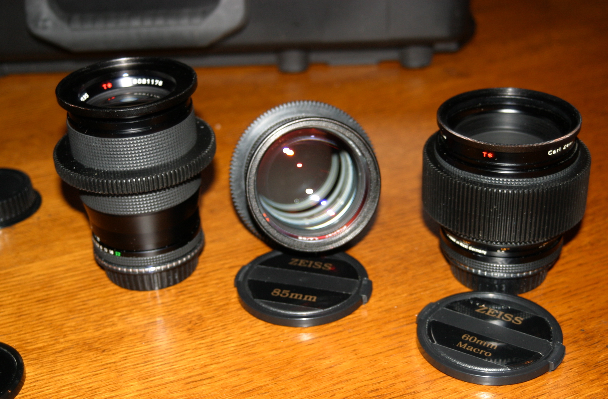

There are a number of options available depending on your budget.
At the top of the food-chain would be having gears professionally fitted to your lenses.
Do you have a per lens budget that you would like to maintain?
Here are a few of my lenses geared.
