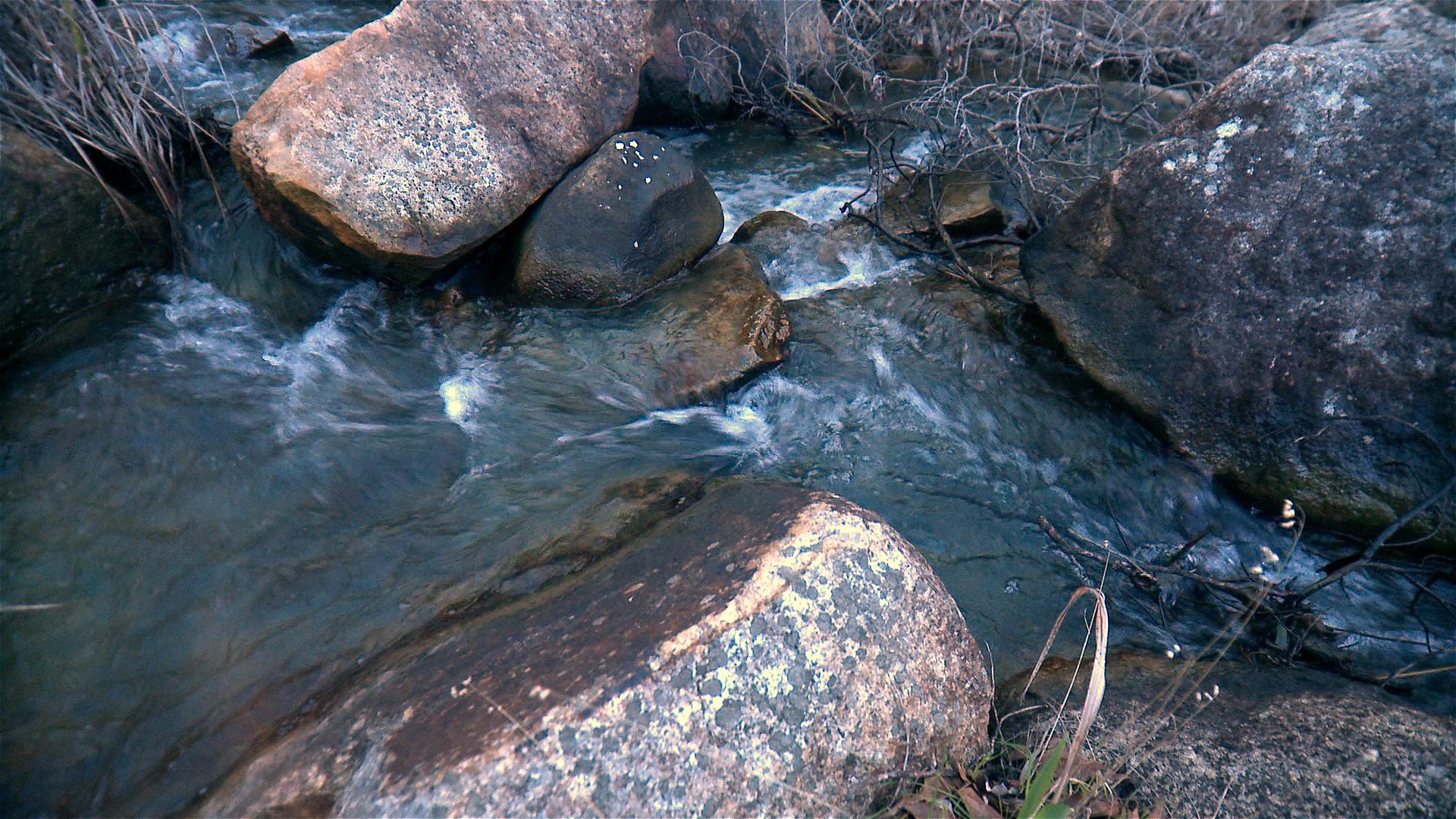

A couple more frames from the creek.
Local wildflower related to bacon-and-egg-plant and remains of the pipehead washed down falls into the scourhole. About 50metres of the pipline was carried away and disappeared.
Being brittle cement pipe, it probably broke up into fragments among the debris going over the falls and may be well downstream by now in the bamboo thickets.
Sigma-for-Nikon f2.8 14mm was used on both frames.

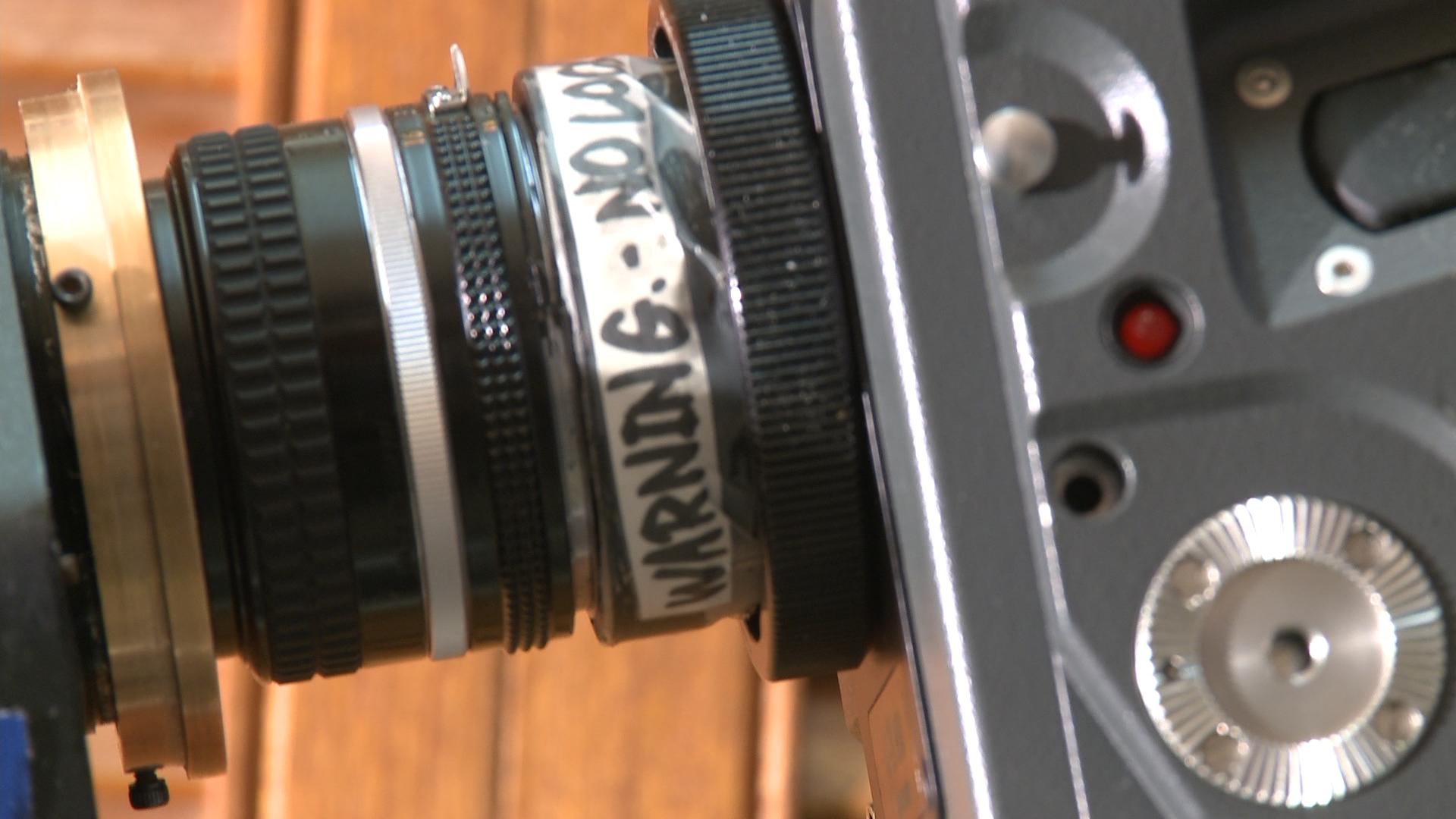

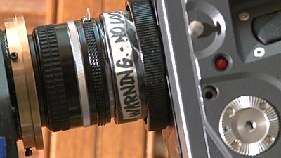

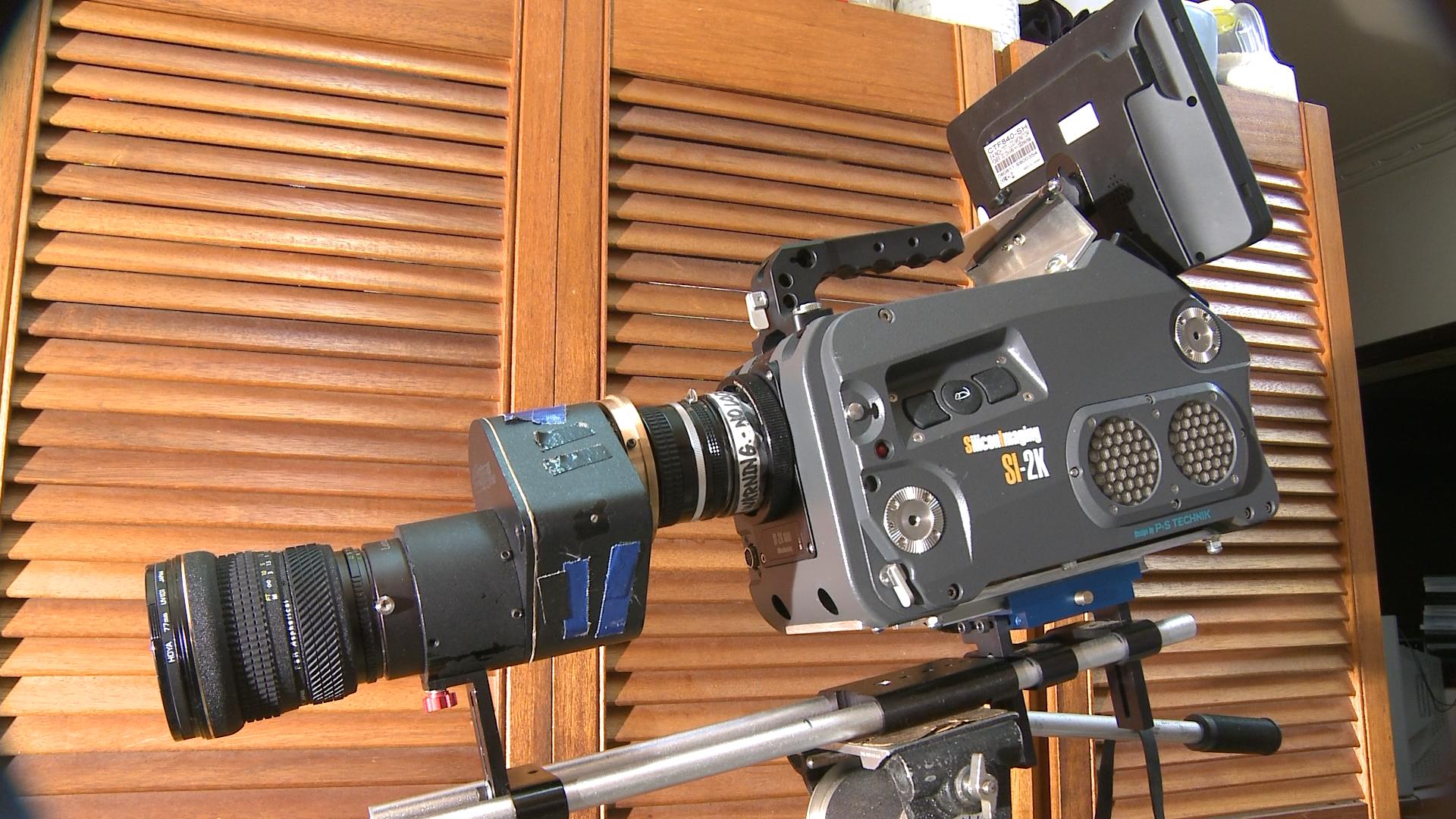

Here are a couple of pics of the Letus Extreme-on-SI2K hack with the EX1 achromat.
I found I achieved much less edge brightness falloff when space was added between the front of the prime lens and the achromat. Best seems to be 79mm, measured from rear of flip enclosure on the Letus to front of IMS ring on the SI2K for the Nikon 45mm f2.8 lens used as relay. In this illustration the Nikon 50mm f1.4 is fitted.
There is a compromise between falloff and loss of corner sharpness when adding distance.
For relay, the 45mm Nikon seems to be the best. Voigtlander 40mm f2 and Nikon 50mm f1.4 exhibited a little more corner softness.
The shoulder on the brass ring is a bit short. It should butt against the rear of the flip enclosure. The material is expensive so I used what I had left over which was a bit short.

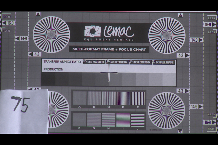

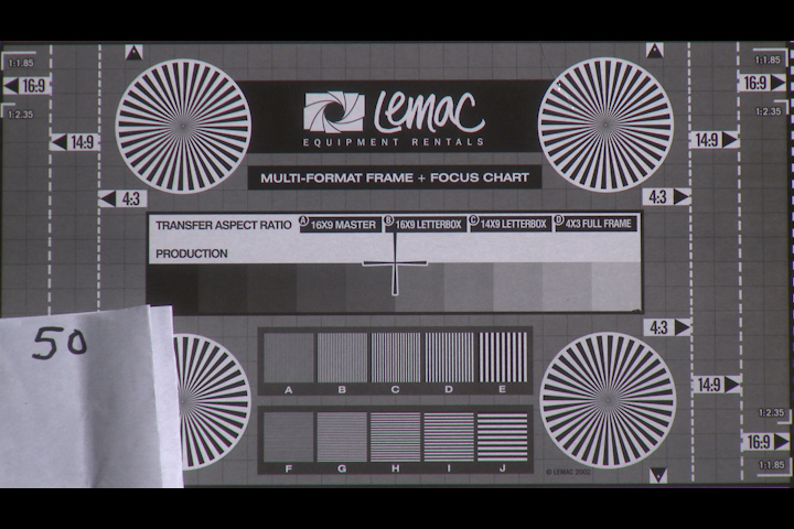

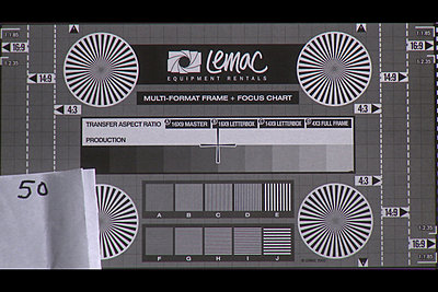

To enable someone to have an idea of how some old Taylor, Taylor and Hobson Speed Panchro Series II lenses looked, the only tools I had were the EX1 and Letus Extreme, so I hooked them onto that and shot a test card. the lenses were 50mm and 75mm.
These are early 1950s lenses and damaged ones at that due to fungus from tropical storage. Despite that, they are still not bad but flary, the 75mm more so due to front surface scratches from cleaning. They throw images with no soft corners and the lines are straight. The lenses are physically small compared to stills primes but throw a wide image. The frame grabs are not the best. They are a bit pixellated.
