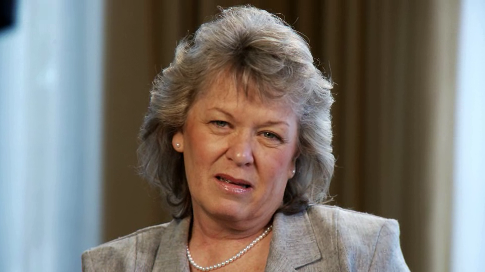

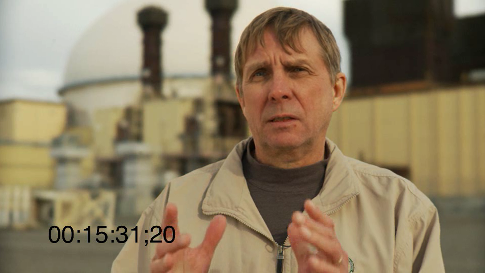

Hmmmm....sorry, I can't answer that Rob, except to say I "think" I can. It's an internal focus lens, and it doens't change physical length when you zoom or focus. But like all the Nikon lenses, the focus ring doesn't have a wide spread like a film lens does. I've done some rack focusing with our 50mm f/1.4 with great results (no follow focus.....yet).
I use the 80-200mm mostly for interviews where it looks great (I'm guessing around 120mm, but honestly I've never looked). The talent looks nice (face slightly compressed) and the background is out of focus like you would expect. In fact my only issue is that I frequently have to shoot wide open with it so when the talent moves around they come in/out of focus, but it hasn't been a major problem. I'd love to try that 85mm f/1.4, expect that it would even make the DOF more shallow. (from 5.3 inches to only 2.6 inches)
Here's a couple of screen grabs of interviews I've done using the 80-200mm and Letus Ultimate. One is outdoors and one indoors. (This is non-color corrected footage that's been compressed to WMV from which I took a screen grab. I'm at home, so I don't have access to the original footage)

That's really interesting. Looks good. You're how far back for those shots? I'm often the one asking the questions, so 50mm is about as far back as I feel comfortable.

ROB: I'm about 10-12 feet back. I've found (by testing and researching) that when shooting people, you want to use a focal length around 85-105mm. This compresses the subjects face and makes them look more attractive. The worst thing you can do is shoot people with a wide angle. (you probably already knew this) This will stretch out their face and make their nose look bigger, etc... This is why I'm shooting with my zoom, so I can utilize those focal lengths.
