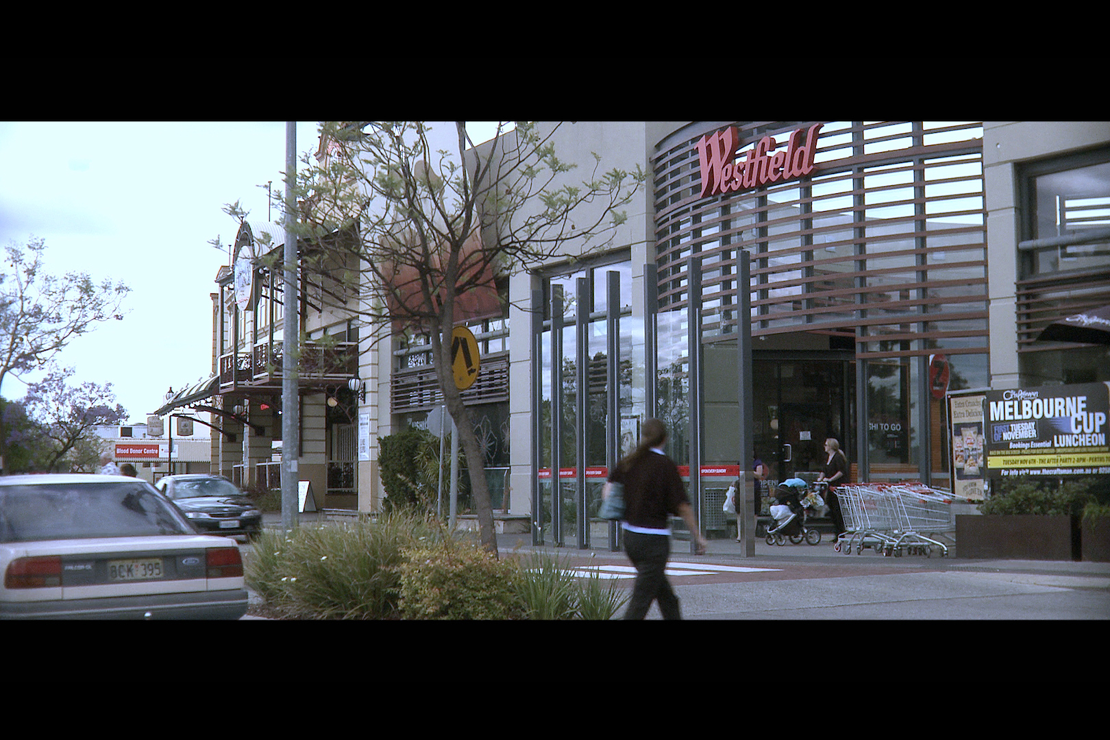

For what it is worth, here is a Letus Extreme/Sony PMW-EX1 frame grab. The combination is to be used for a music video this weekend by choice of the producer. It is illustrative of how the operator has to be a little more vigilent than when using a simple 35mm format video camera. This Letus has been modified and the frame area in this instance was a little too wide for the lens used.
