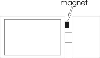

used a magnet to flip the image right side up ...
Can you post a pix or a detailed explanation of HOW you place the magnet.
And, what kind of magnet.

I believe it's called a rare earth magnet and I got it from a friend that I work with. Google has lots of info n these.
The placement went on the side of the LCD but there is definetly a sweet spot. You kind of have to tilt the LCD up and down while sliding the magnet around to get it to flip. And when it does flip the image is still flipped horizontally. So pan left, on screen it goes to the right.
That messed me up pretty good.
