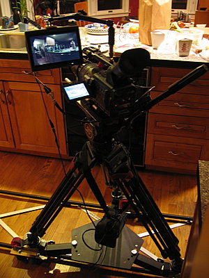

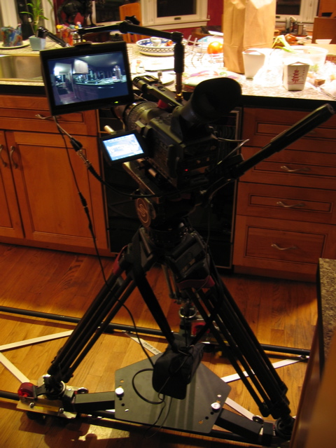

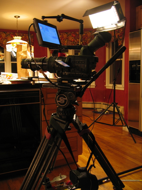

I only got this Brevis35 (Rev1) a few days ago and am in the process of testing it. I've done a very low lit indoor scene to test how the Brevis works in low light, along with the HVX. I shot everything wide open. The lenses are Nikon and the video is marked to which lens is recording which scene. The slowest lens was the 17mm at F 2.8. The scene was lit with a Kino Flo Diva light dimmed to about a third of it's output and lamped at 3200K. The practicals in the ceiling were 3 60W spotlights. The hanging lamp in the background is 40W.
I've found focusing very difficult, especially on the wider lenses. The 17mm was the most difficult and I think it looks soft. The focus plane for all the shots is at about where the tomato is. I don't have an HD monitor and instead was using a 7" Panasonic LCD SD monitor. There are pics attached of my setup.
You will also see if you look closely to the right edge of the frame a little bit of movement from the vibrating Ground Glass. I wasn't zoomed in enough. Even though I go past the safe area in the HVX viewfinder, you still have to go a bit further. This ruined a lot of the tests I did outdoors (that's why we call them tests!!)
http://homepage.mac.com/getken/hdtes...Theater47.html
Brevis35 test, same scene different lenses, HVX-dolly1.jpg   Brevis35 test, same scene different lenses, HVX-dolly2.jpg

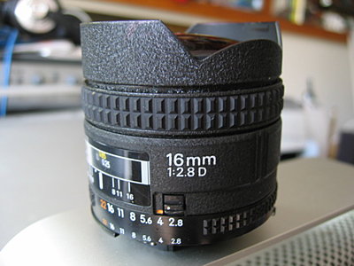

Frank, I must make a correction. Upon further inspection of the fisheye lens I have discovered that it is not a 17mm, it is in fact a 16mm:
Nikon AF Fisheye 16mm Nikkor
Here's a foto:
