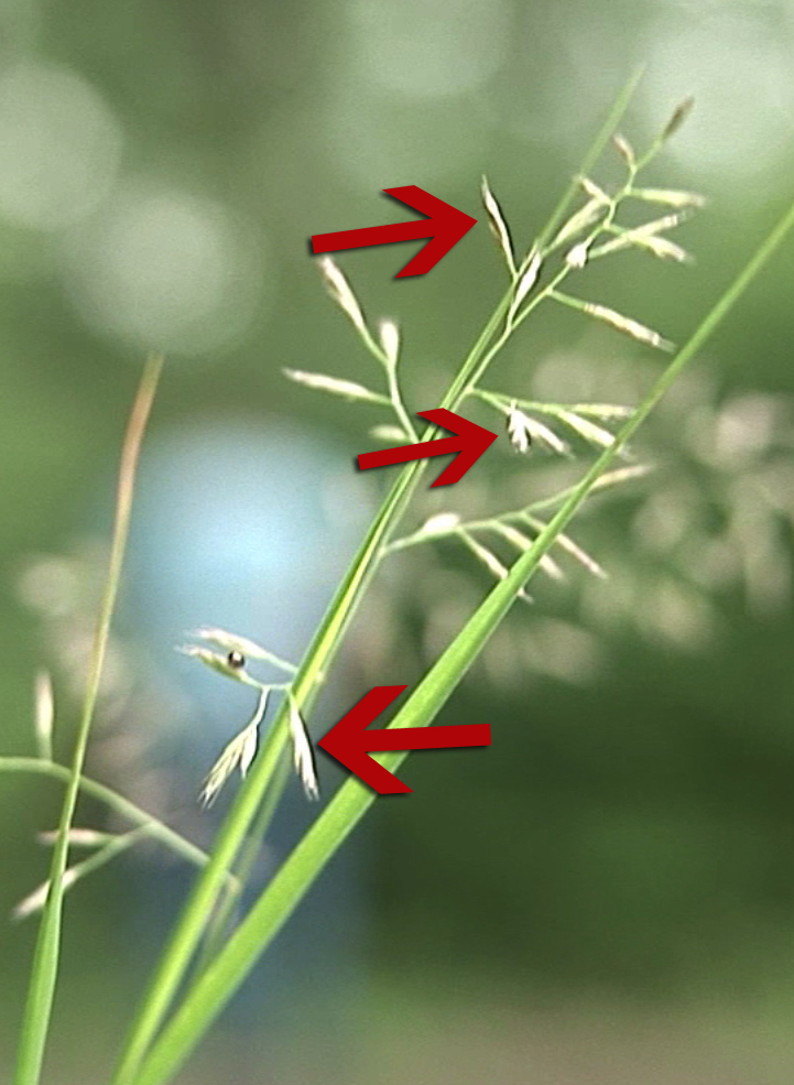

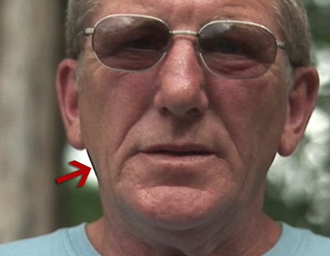

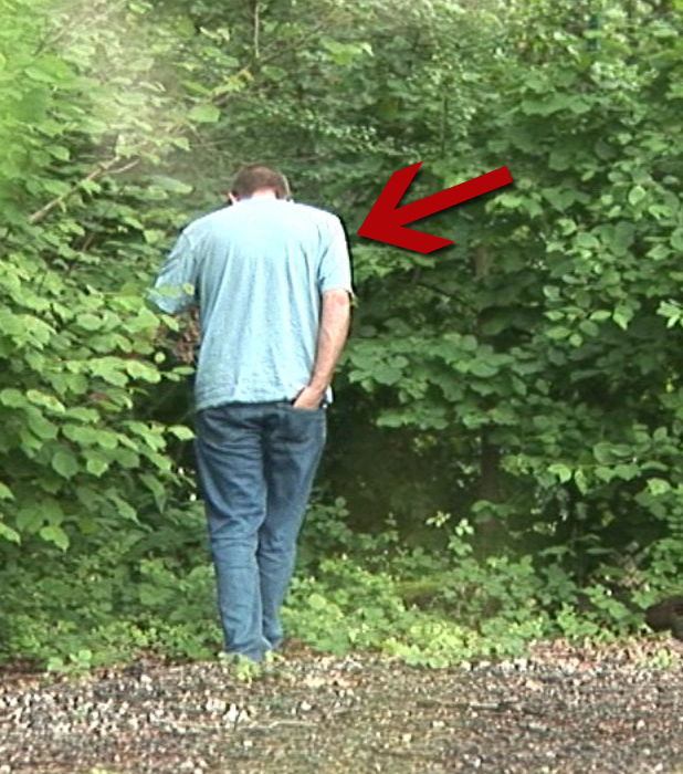

In both clips, there's a weird black outline on objects when they're in focus (wheat, left side of the man's jaw, right sleeve of t-shirt, etc.) they're in the frame grabs as well... what's causing that? The camera?
Originally Posted by Wayne Kinney View Post
Not too sure what you are refering to?
The only reason I noticed it in the first place is because it comes and goes.

Gotcha!
The sharpness setting on the FX1 is set to 12, maybe its too high.
Wayne.

Sounds like the culprit for the black edge and the bokeh grain.

Yeah, default is 8 (middle), i set it to 12, months ago, when i first got the FX1.
Maybe beyond the cams ability, huh?
Wayne.

And I've always been impressed with the SGpro. Really fantastic work Wayne. I'd be an owner long ago if I didn't have a vendetta against The Box design (shudder). Keep the sharpness at or below the 8 setting, and you should be fine.
