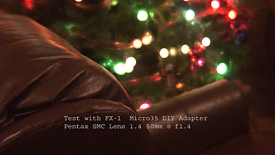

Okay, so I am knew to the Bokeh discussion. So what makes good or bad bokeh. For instance here is a grab from my Micro 35 DIY with my FX1. does this demonstrate good or bad bokeh....
Note, I forgot camera had autogain on so it was probably pushed to 12.

There is lots of discussion in the photography realm as to what makes good bokeh, but there is definately disagreement between what is pleasing or displeasing. Ultimately it is a matter of preference. I prefer harder bokeh while others prefer what has gaussian dropoff or something like that. It is whatever is pleasing to you that I think is important to achieve.
BenWinter.com

Very true, it is a subjective opinion, but mostly the photography realm are talking about the bokeh produced by the lens. In the 35mm adapter realm, we are mostly talking about the adapters (or more its ground glass) ability to capture/render that bokeh so that it looks identical to how it would be if shot directly to film. I think its important to seperate these two in our minds as they are not the same thing. In fact, its probably the wrong term refering the GG's ability to render it as 'bokeh'.
