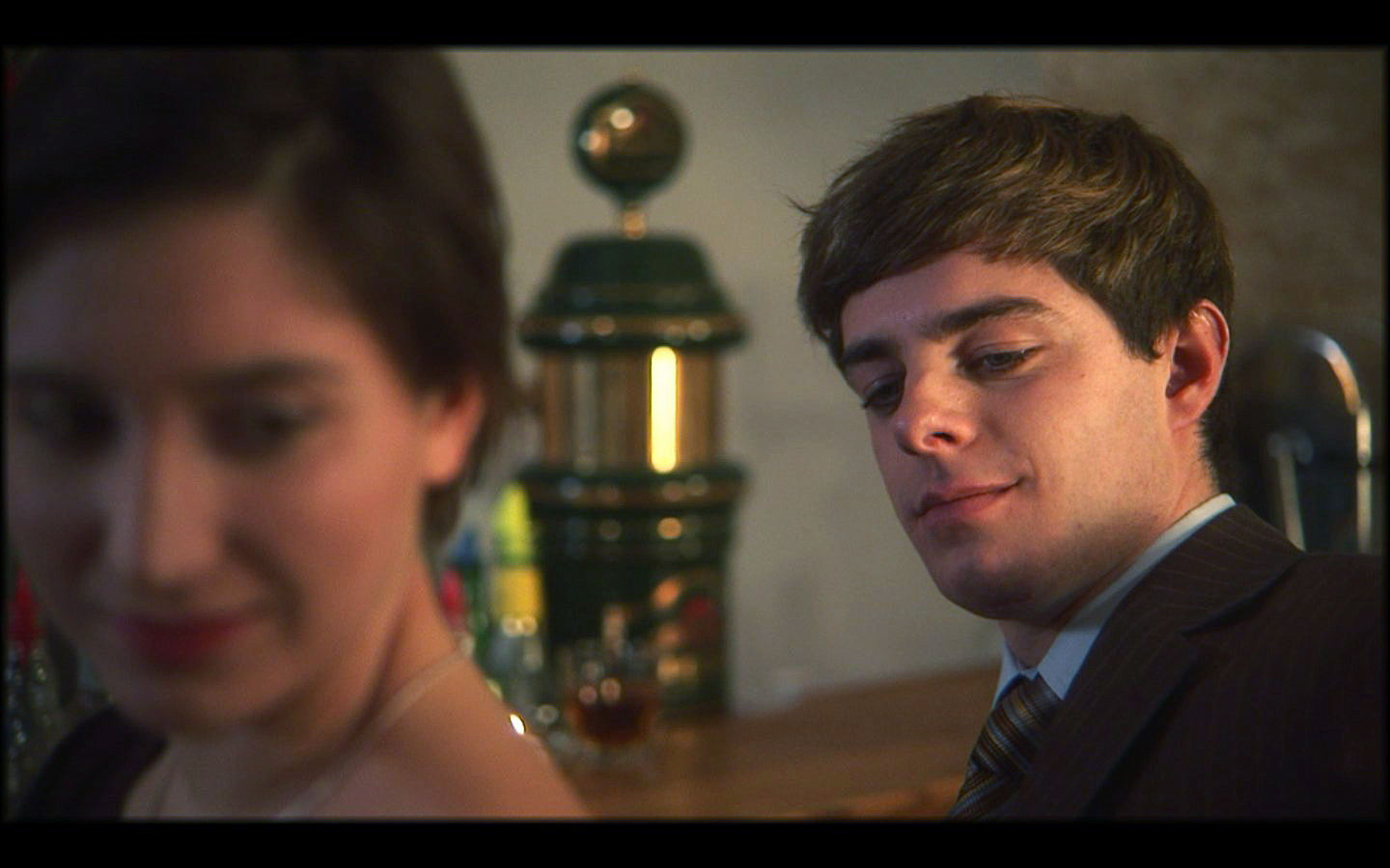

How does something like this look?
Notice how once you do some basic color correction "sharpness" can actually appear... well sharper!
Ah the tricks of the trade.. "sigh"

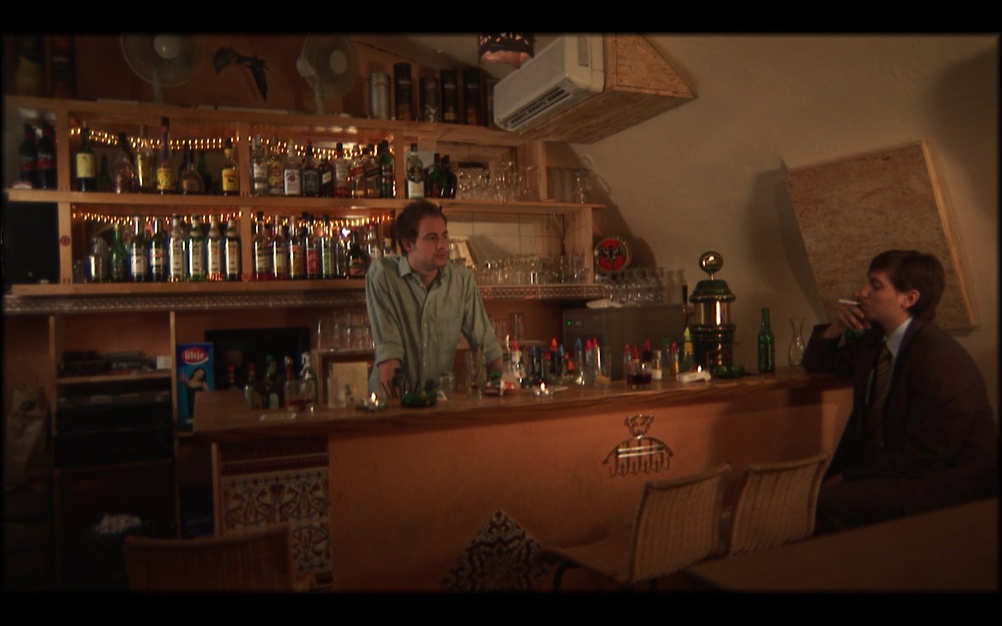

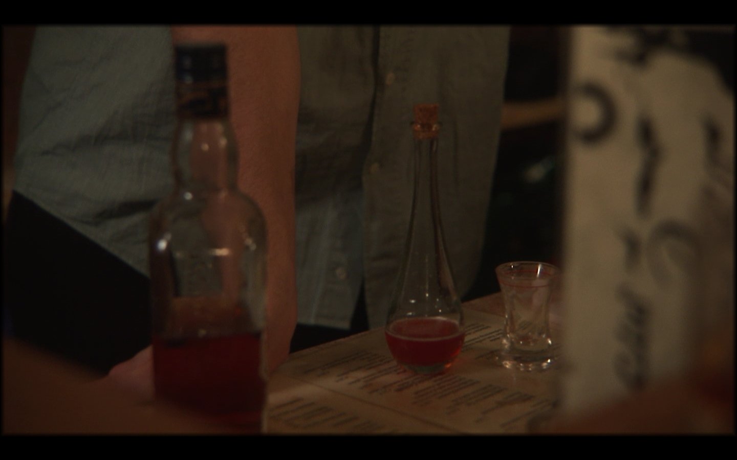

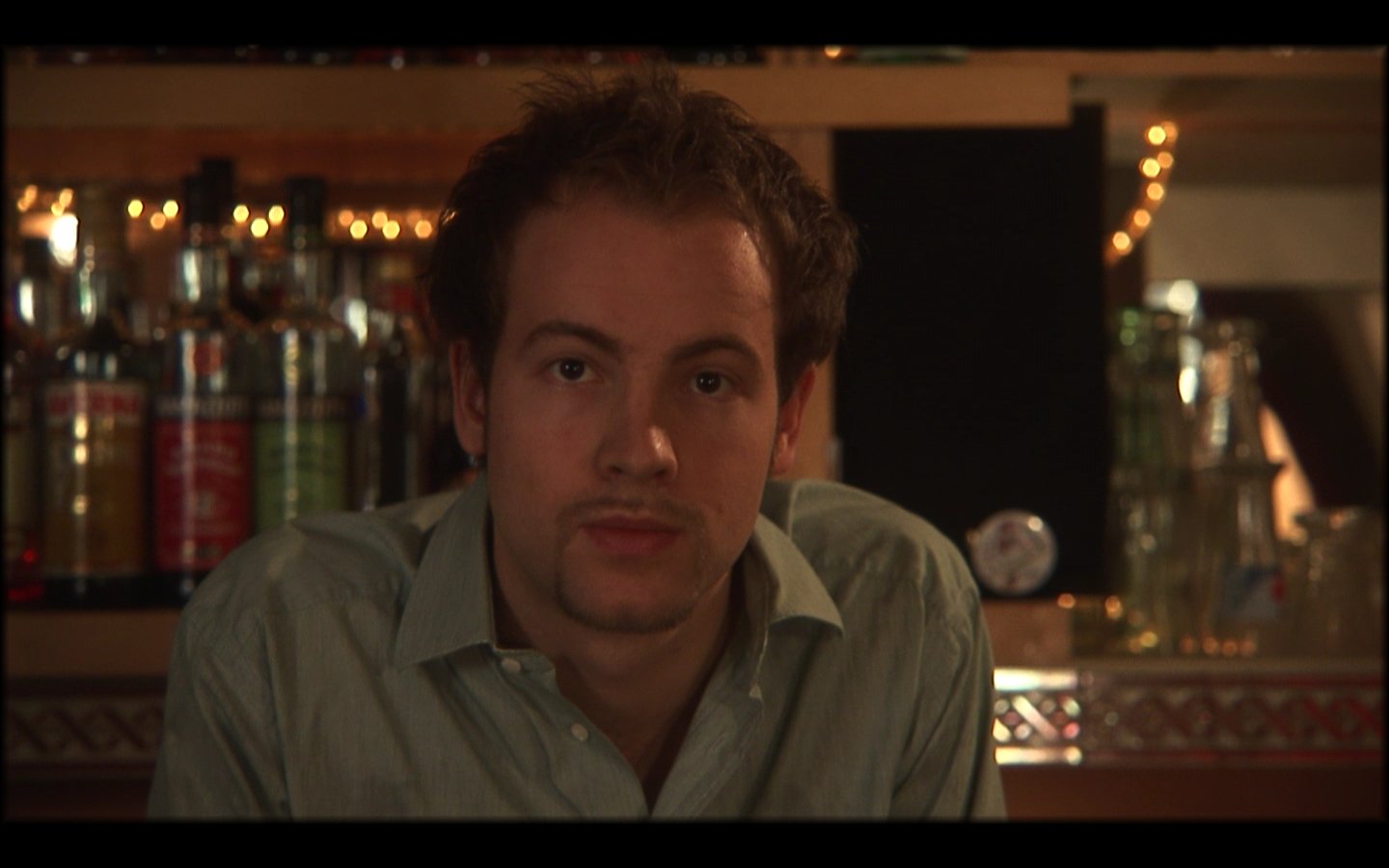

These are set in another "layer" of the plot and deliberately underexposed to look dull (dirty bar). The earlier shots were intended to look glamorous. This time I have added the lens in the filename. Again, no CC.
One of the first short films with SGPro/FX1 combo-establishing-shot-24mm.jpg   One of the first short films with SGPro/FX1 combo-barkeeper-portrait-reality-75mm.jpg
One of the first short films with SGPro/FX1 combo-close-up-magic-bottle-75mm.jpg

I have furthermore uploaded a second clip, with some more footage (to get a bit of variance). This one is set in another layer of the plot (see last post). Apart from the shot lighting the cigarette in the end, which belongs to the "glamorous" layer. Look at the apperture discs in this shot! Awesome - props to Wayne's GG.
