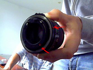

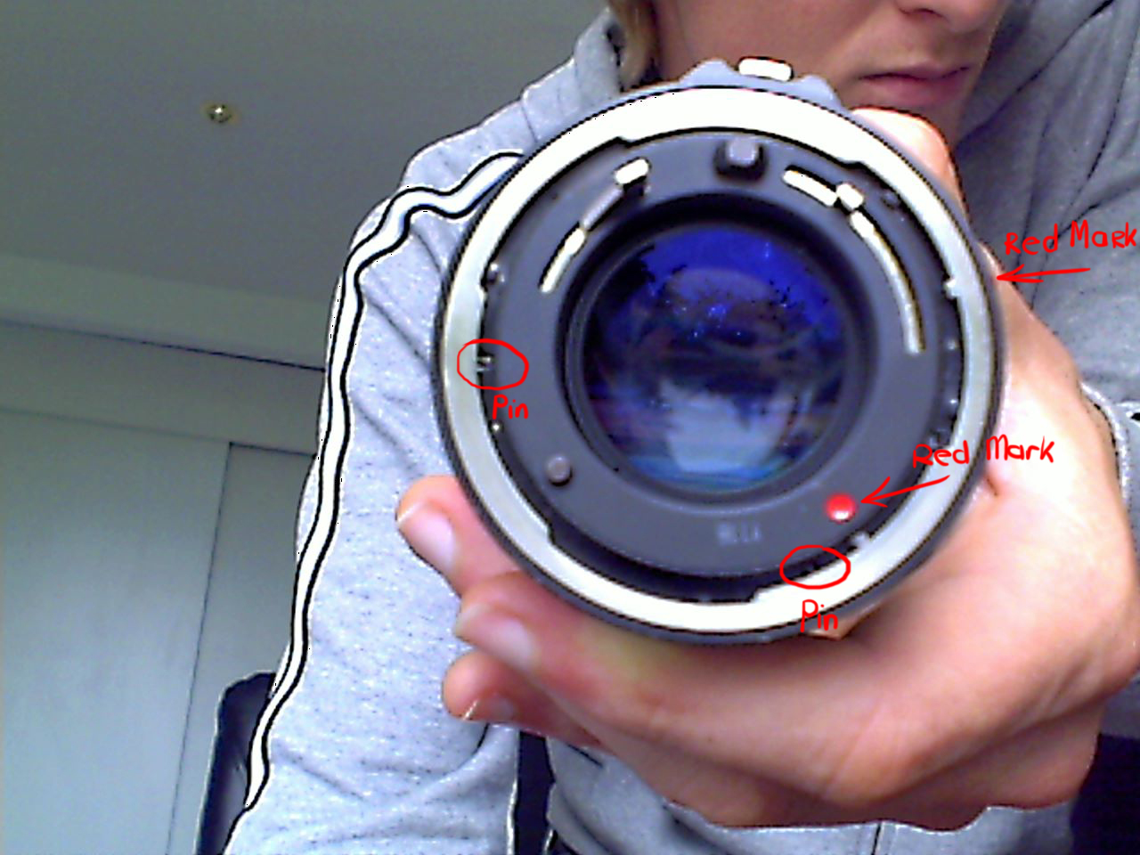

Hi guys,
I just received my LetusFE and wanted to put my Canon FD 50mm lens on. I have unlocked the lens, but somehow the both the red marks (outer and inner) are not aligned anymore and I can't seem to get them back together.
What can I do about this?
The problem is that the lens won't fit the Letus this way.

Wayne Kinney helped me out on this one. Seems I had to push the release button and turn the lens back to the red marker. I thought the release button was just for releasing the lens, but hey... at least I learned something new again :)
