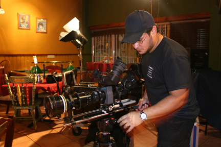

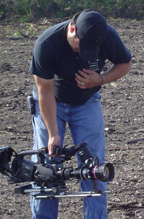

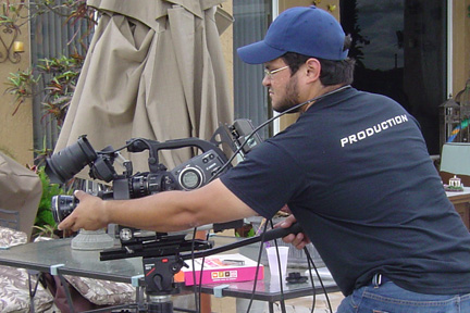

Hello,
All depends on your setting, for example we got a Mini35 with an XL-H1 so our setting is not based in a built in lens, the Mini35 goes attach to the body of the camera and the focus and the zoom we do it directly on the Film PL mount lens.
We preffer and trust the use the XL mount type of Mini35 setting, because having to many people in a set you never know if some one by mistake mite mess up your camera settings.
Check out my picture attached.
Take care and good luck,
Blessings...
