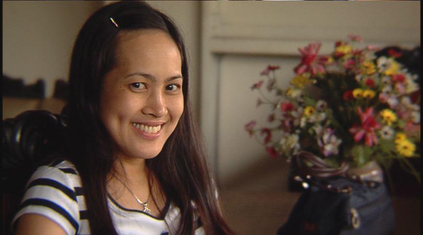

Its not the CD case but a frosted CD, the dummy CD you find at the top and bottom of a spindle of CDs when you buy them in bulk, say 25 or 50 pcs per spindle, actually I used this in mine. I think it came from a maxell.
Heres a grab from an 80mm lens at f1.9 to show you what a frosted cd can do.
But of course I wont discourage you from getting wayne's sgpro which is among the best adapters out there together with the Brevis and M2.

that pic looks good
is that a frame grab from raw footage or corrected?
what cam was used, u shoot in hd or sd?
thanks

Its from raw test footage, uncorrected, just flipped in post.
Shot in 24p with jvc hd100.
