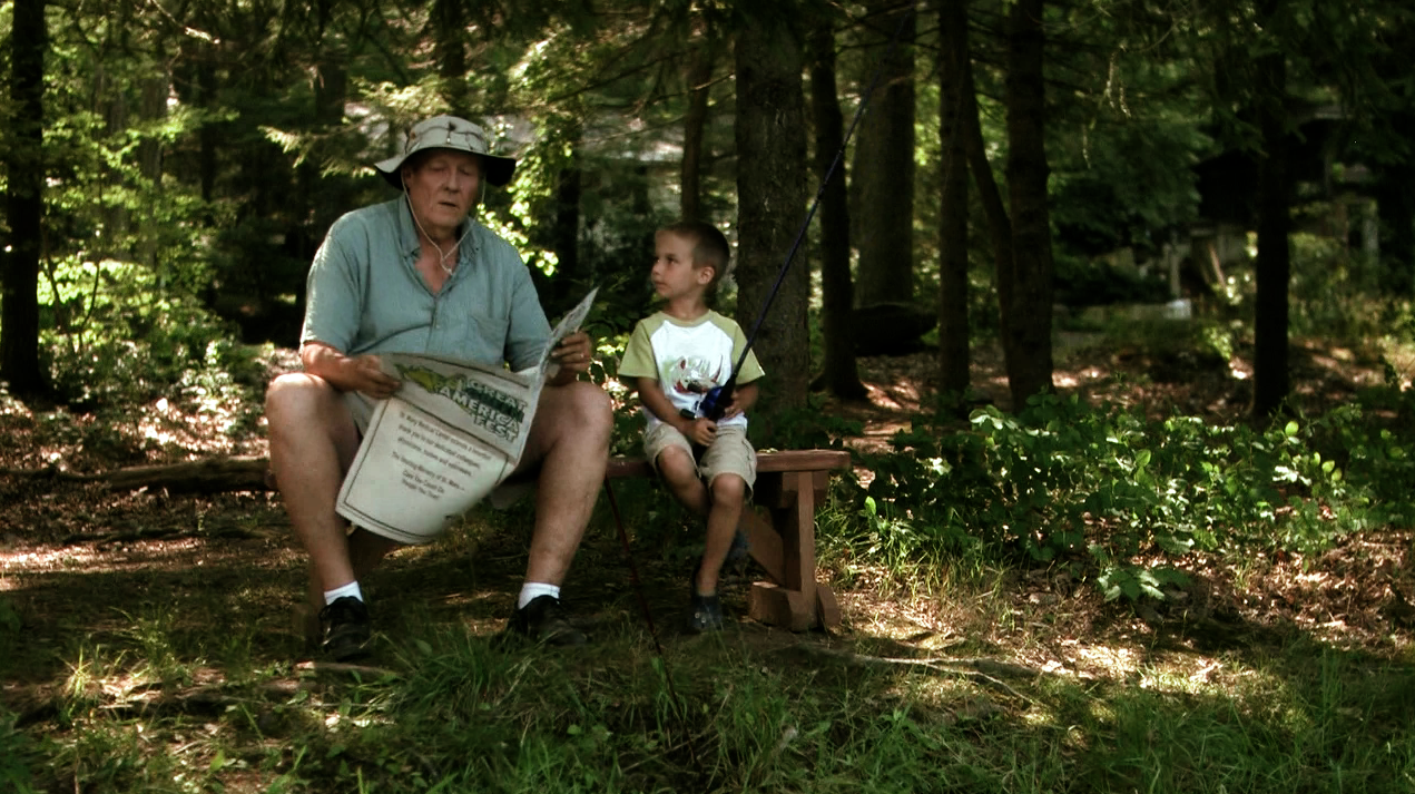

I was curious what some quick CC would do for the default H1 settings as I'm considering this camera for myself. I dropped your quicktime into my timeline and a few seconds later.... 'Great Green' really comes to mind.

Thanks Travis !
What's wierd is that's more what it looks like in post....
I don't know why the Avid Adrenaline...washed out....the jpgs.
the spot doesn't look like that....very close to your "color corrected" version...
