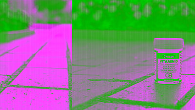

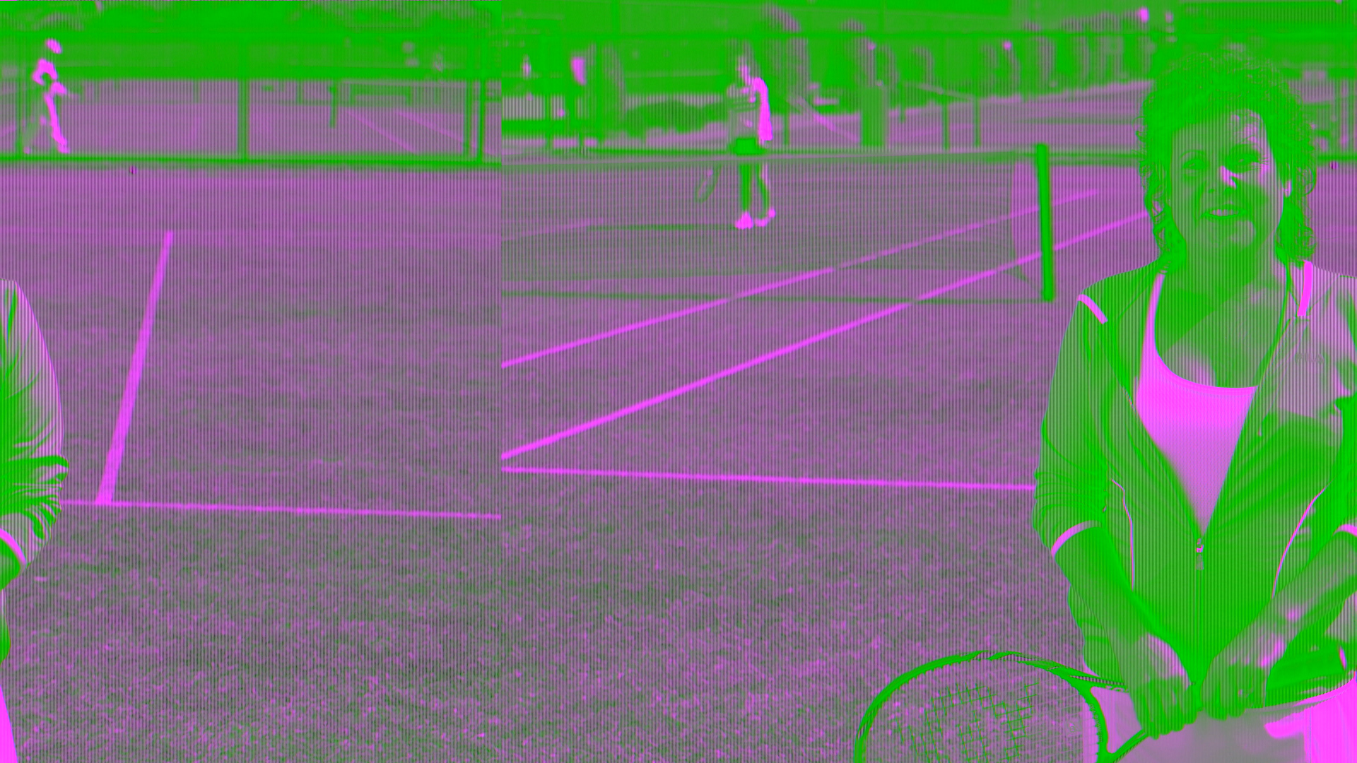

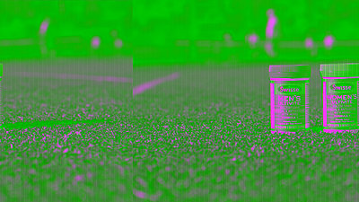

Got some weird green screens on some Samurai clips.
I got several green captures the other day on a 117-clip filming session. 16 had this effect. I had the SxS card from the F3 so I'm not stressed about it, but has anyone else had this?

I thought I saw a single green frame at the end of one of my clips when I had it on the timeline but not sure. Definitely not seeing this regularly in any other clips. Does this just last for a single frame or a long sequence?

Atomos are working on it, but I haven't heard anything back.

I am having these problems too - see there is a new firmware update available that addresses these issues that came out 30 January that says it addresses. trying this out asap. Atomos is responsive to concerns - love it!

So, if I understand correctly, the firmware update, ATOMSAM_v2.61, corrects this problem?

Even newere - the firmware 2.7 update - used it yesterday - super flawless.
