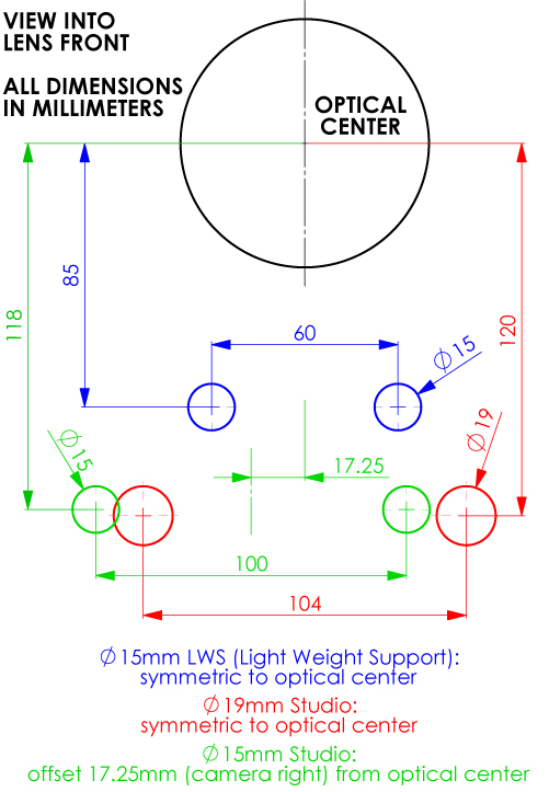

Yes, standard sizes. It looks like the Wooden Camera one might need a threaded rod. I can’t tell if the threaded holes go all the way through so you might not be able to just use a bolt. I’d call or e-mail B&H and ask them. I have my Samurai mounted to a hot shoe monitor mount by one screw and it doesn’t spin loose. I do check it frequently, though.
