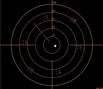

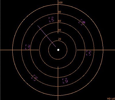

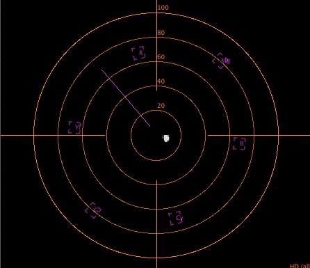

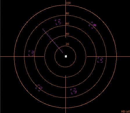

First, folks are confusing a TOOL with its use. The former is the realm of science and the latter of art. In the world of art it's all subjective.
The goal of science is to make a TOOL that imposes nothing of itself. An amplifier should be as transparent as a piece of wire. A camcorder should record exactly what's in its view. Nothing more and nothing else.
Of course, mics and lenses are often bought and used based upon HOW they sound/look. Most of can't buy that many camcorders and lenses.
Measuring noise is nothing new. Each has a signature and so can be measured. On analog tape there were two types: AM and PM. PM was subjectively the worst. Both were measured. In fact, it's safe to say no review of an analog VTR was without both measurements.
Same for Wow and Flutter. Same for sensors. The idea that because something seems complex it can't be measured is simplistic. For example, if you have the money you can measure compression codecs. How do you think MPEG-2 and MPEG-4 were developed? There are a standard set of test images and sequences everyone uses. Then codecs are measured.
Without standardized Test and Measurement no product would come to market. No could QC be run on the production line. Networks would not buy 100 camcorders because a few shooters played with it for a few days.
For example, person A can claim that the SR12 has good AWB. Person B can claim it has "blue push." You as a reader can't tell a thing by these opinions. If person A has an uncalibrated monitor it most certainly has red push. Red helps warm the blue and his eyes tell him all is well. Person B has a calibrated monitor -- now the image is seen as it IS.
But there's no need to ever SEE a frame of video. Look at the 2 vectorscopes below of AWB and MWB. You can SEE immediately that the uncentered AWB is not correct. So one can conclude that the idea of running the SR12 in AWB is dependent on the viewing monitor and the BELIEF about skin looks like plus what an individual believes is ACCEPTABLE. (When I claim skin is white, look at the photo below.)
Plots and graphs are as SEEable as video itself. Look at the static rez shot of the SR12 vs HF10 on the "other" site. Not only can you SEE the Sony has lower resolution one can SEE by looking at the concentric circles it has diagonal aliasing. Look at the plot of frequency response on a German site. You can SEE what is happening to the signal.

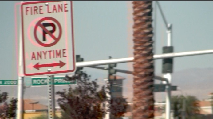

PS: Has anyone seen the type of field problem in the uploaded pix?

"PS: Has anyone seen the type of field problem in the uploaded pix?"
Can't say I've seen this before, but It's obvious the red channel is out of "sync" with the blue & green channels. Is this a progressive frame, & which camera shot this, if you know.
The Sony SR12. It's about 10 frames from the end of a clip converted to AIC so I doubt it's in the actual AVCHD file. Amazing -- AVCHD is the first codec that one couldn't natively play in a player without buying something.

yes this seems to be a known problem on avchd camera.I have seen a french video forum where some guys where asking same question.
Seems it happens when doing a fast pano.
