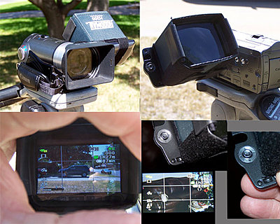

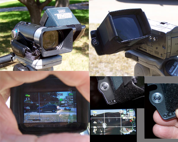

Working in bright daylight with only the LCD screen as a viewfinder is a nightmare for me. First I tried the Hoodman product (the plain one without the 2x magnifier) and found it so flimsy that in addition to being too small and short to be effective, it kept changing shape on me.
The Cinetactics Screen Hoodie was some better, being much more substantial it kept it's shape and also could be "closed down" a bit making it some better at shielding the LCD if you got your face close enough. But then my eyes don't focus well that close.
The latest thing being tried is the Hoodman with magnifier. The lens actually gives the hood some rigidity to hold shape and helps when I get close enough to block some light. But it is still too short and needs some kind of extension (I'll work on that when I have a chance).
For now it does work better than anything I've tried yet. The photo below shows first a montage illustrating the Hoodman with magnifier. You can see the hood can be postioned so you have access to the the joystick on the screen frame, and it is possible to shove a thumbtip up under the hood to press the function button.
The playback functions need to be addressed with the remote.

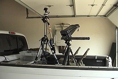

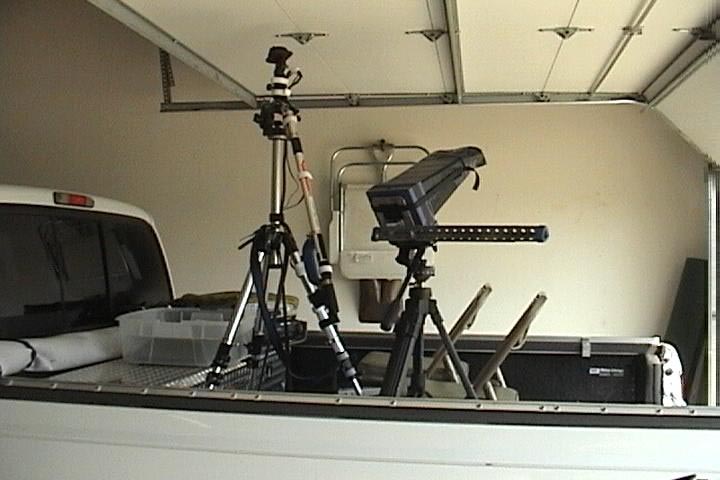

Depending on what type of Video you're doing, it might be even better to set up a seperate small monitor. This is what I've done - I seldom use the Cam's Viewfinder or LCD except for start up.
Here's a sample of one of my monitor setups, with a full hood with full dual eye cup, used outdoors for Horse Shows.
Check my other posts for more photos of this, and lots of other equipment mods.
Harold
