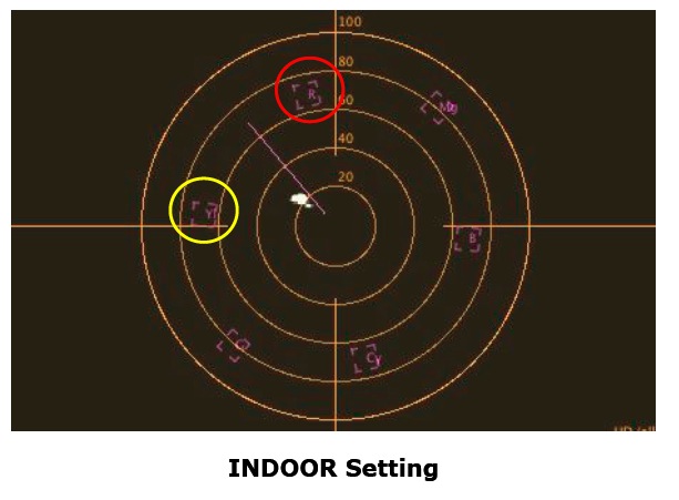

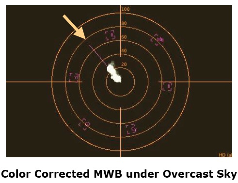

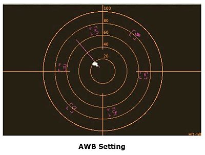

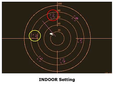

Measurements of AWB and INDOOR in bright -- not dim -- light. Note, all show a lack of perfect WB -- easily seen by the experienced eye.
The final pix shows how skin looks after CC of MWB. Note the skin lines-up on the "flesh" vector. Now one is getting the best from the Sony. Something one wants before burning a $25 Blu-ray disc.
Sony SR11/12 Twilight Mode-picture-1.jpg   Sony SR11/12 Twilight Mode-picture-2.jpg
Sony SR11/12 Twilight Mode-picture-6.jpg   Sony SR11/12 Twilight Mode-picture-9.jpg
