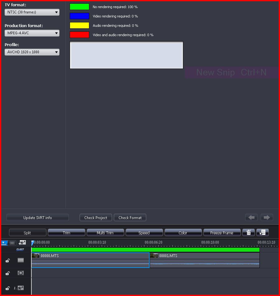

Place multiple clips on the timeline from your camcorder.
Use the menu option VIEW--->SVRT Information to show the details of smart rendering.
Use the attached JPEG to see what your screen will show after the settings are correct.
Make sure to select the correct Production Format (MPEG4 AVC) and Format (AVCHD 1920 X 1080).
Push the button labelled Update SVRT Info.
You will see a green bar showing up above all clips which will be smart rendered. If you modified any of the clips by adding, for example, a filter or effect, the bar above it will turn to one of the three other colors shown in the Legend above -- telling you that this particular clip will NOT be smart rendered.
Hope this helps.
Larry

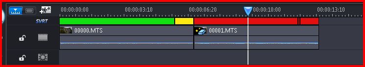

Also Peter, see 2nd attachment below which has both smart rendered as well as not smart rendered clips on the timeline.
Larry

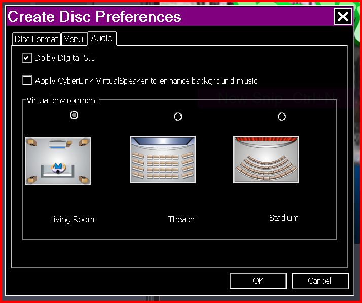

You might try the following Mike:
Go to Create Disk Preferences and set the default Dolby mode to 5.1.
Unlike my Canon HF100 and most other AVCHD camcorders, your camcorder captures 5.1 audio, and the Power Director 7 software can be configured to use it if you change the default setting.
See the attached screen shot showing the screen and check box you need to use.
Hope this helps.
Larry

Originally Posted by Larry Horwitz View Post
Mike,
Hope this helps.
Larry
Yes, this is already set on. But the clue lies in the fact that the sound track displayed directly under the clips on the time line is shown with only 2 tracks. PD7 is, like Pinnacle, at present incapable of handling the 5.1 camera output from the increasing number of cams that support it. I really miss it now after a downmix. So it's back to Sony Vegas Platinum I think, despite its lack of smart rendering. VS11 also handles 5.1 properly, though it still has its own smart render issue on AVCHD clips...
