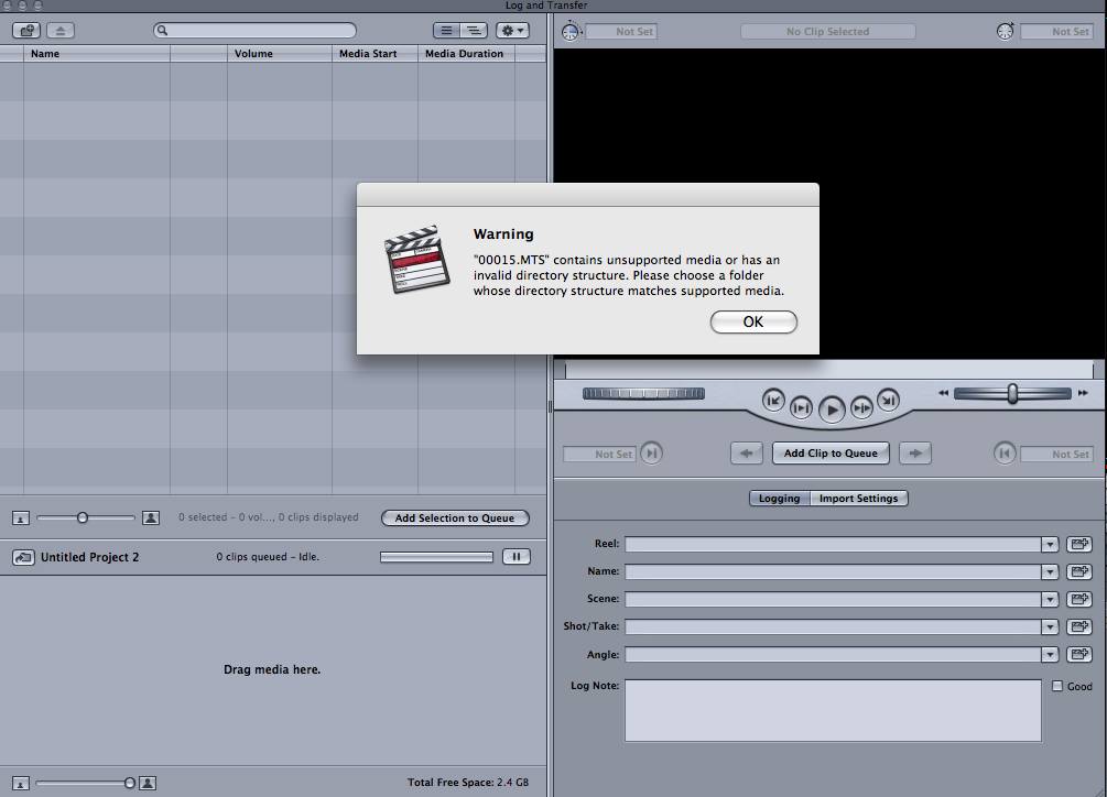

Hi, i have a problem, what is the file ext (0001.MTS) you drag in to fcp, or use the log and transfer, i can not get any files to open in it. I have plug the camera in, no go, then i copied some files into a folder (000.MTS) still no go. yes i have a Intel, mac pro, latest FCP.
ROB ?
Screen Shot Added next post
Rob.

screen shot
This is the screen shot error if i try to drag in a file

When I plug in the camera and open Log and Transfer, all the clips appear on their own.
When I do it from files I've copied to the desktop, grab all the folders and drop the whole thing into the window, and the clips appear the same way. A total of 4 folders come from my camera (Sony TG1). I think the system wants them all. I haven't tried to pick and choose some of them. I figured if I just drag the whole bunch, then it would act the same as when the camera is connected, and it does.

have you tried copying over the whole private folder when saving the clips off of the camera/memory card?
that will get the clips as well as the specific directory structure and accompanying files. Then you should just be able to point Log and Transfer to that folder. (in theory. i've only got FCP4, which doesn't even have log and transfer, just log and capture)
