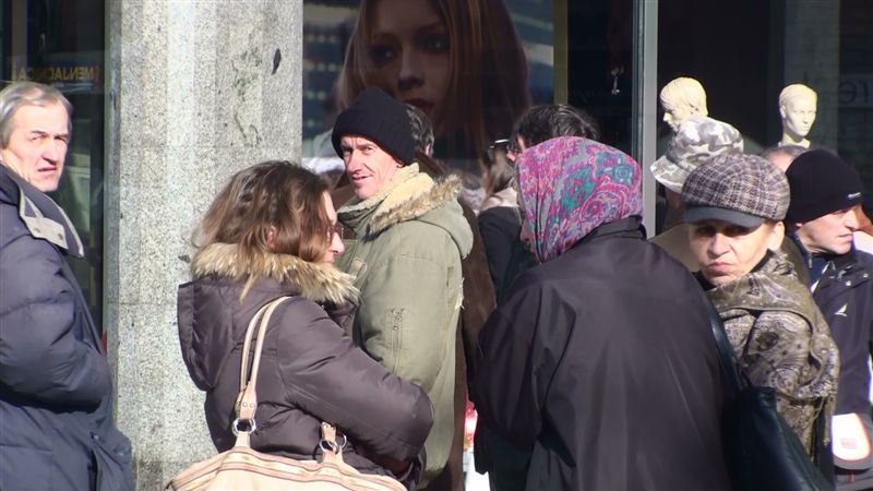

if your `millage will vary` means that i am not handling the camera right, i am hoping that you are right.
in good lighting camera is OK, where the iris is narrow, depth of filed solves the big deal of the problem. i am not doing a lot of stuff outside. but indoors and low light is the problem. tele and wide open iris and your problems will begin for this camera, my experience.

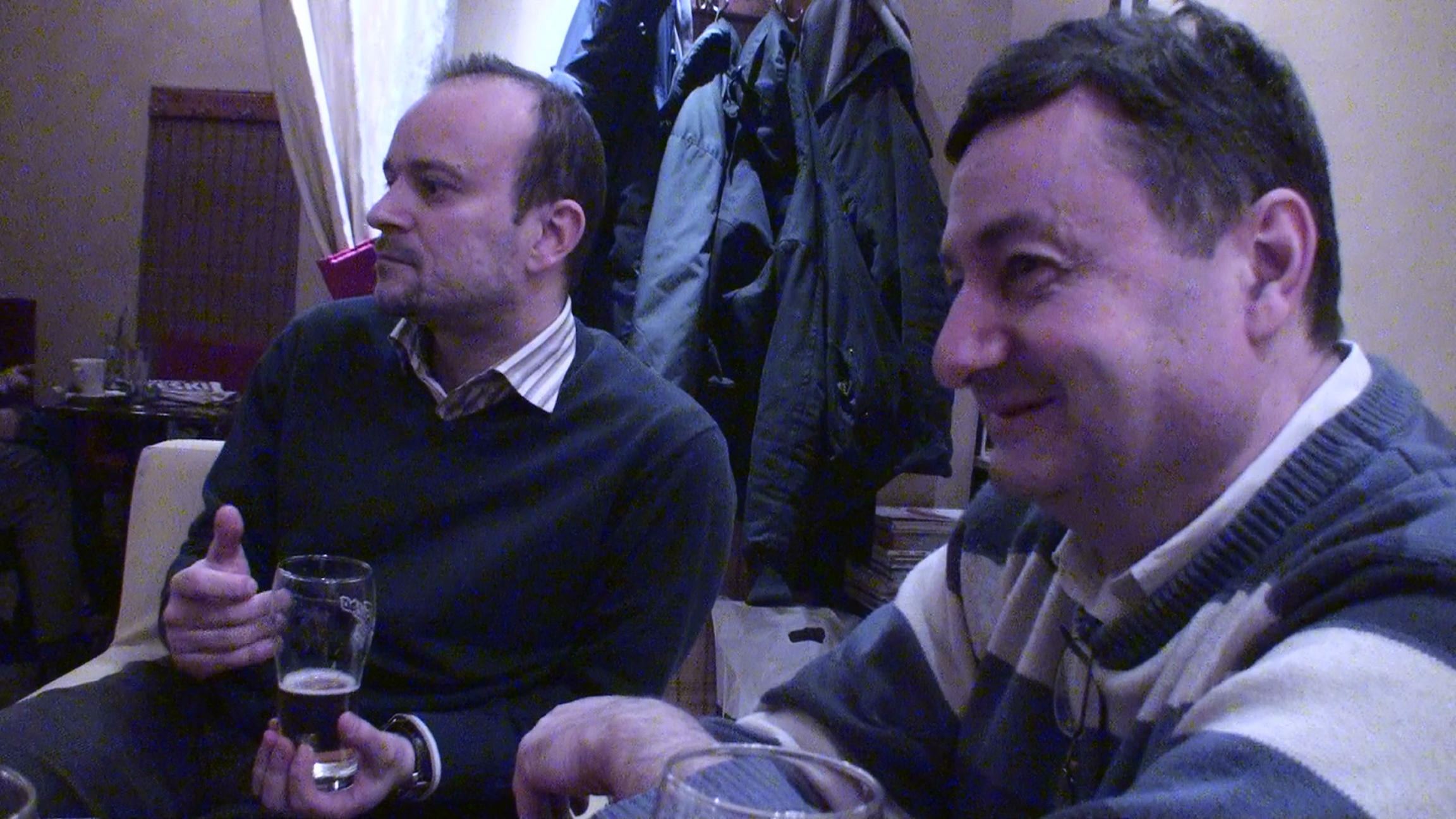

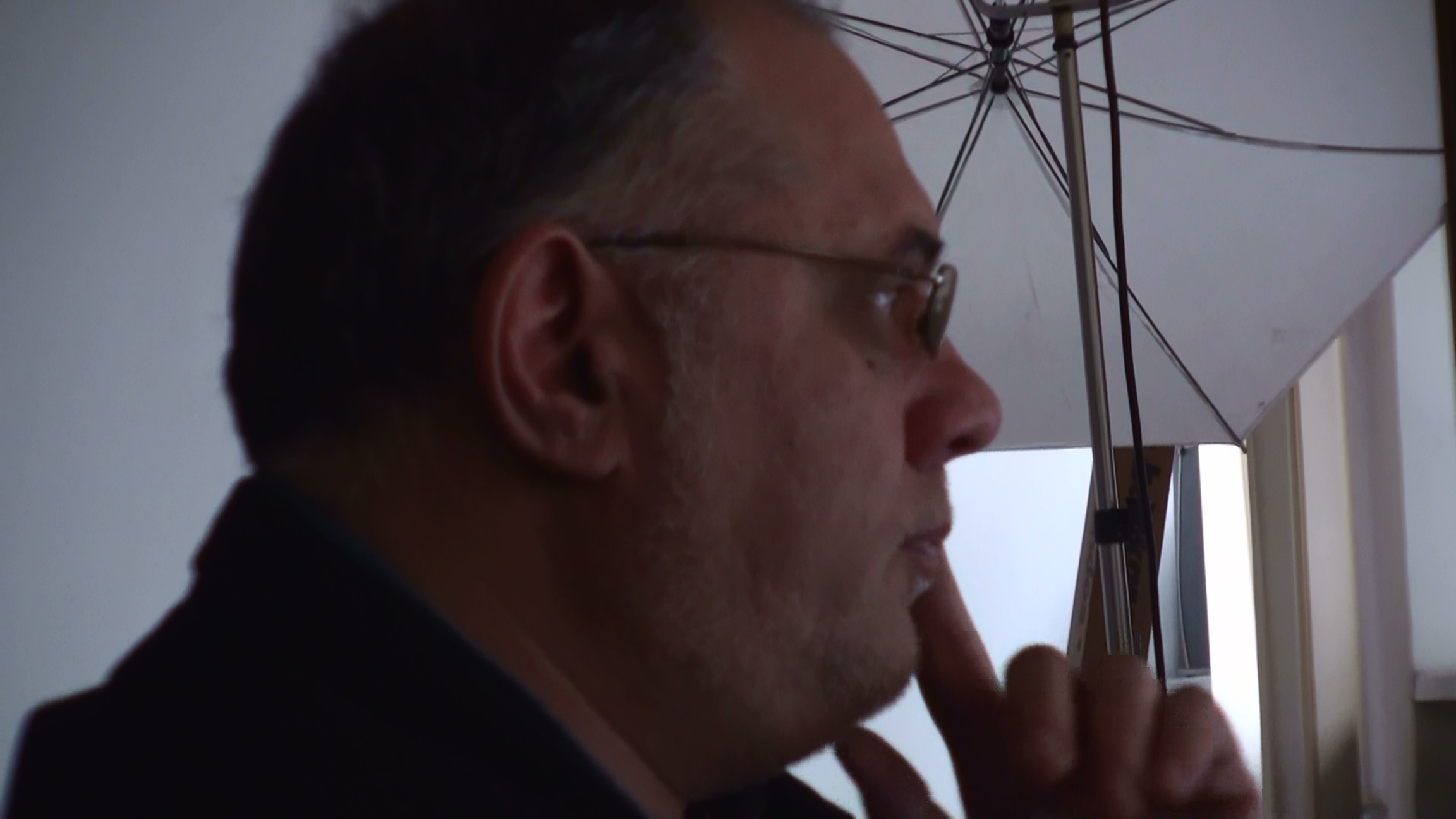

here are the examples.
if sometimes in million cases canon fails to deliver sharp focus in same situations you just literally shake it centering the subject and focus gets it, and from there you are safe.
sony is always catching the easiest thing to focus, which is horrible solution.
the tele position was in range of a focus, it is not the problem :-)

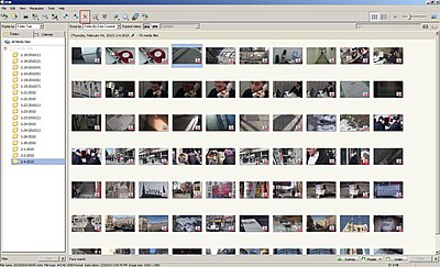

P.S. the PMB sony browser rocks - this thing is making my day. excellent tool. fast, not processor/memory demanding, very organized and viewable. the BIONZ should be programmed by this falks :-)
any way to tell PMB to delete videos after importing? - i saw this option once on some menu that popup just once, and clicked it - but nothing happened and that popup i cant find any more?

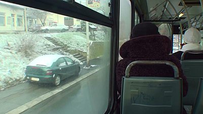

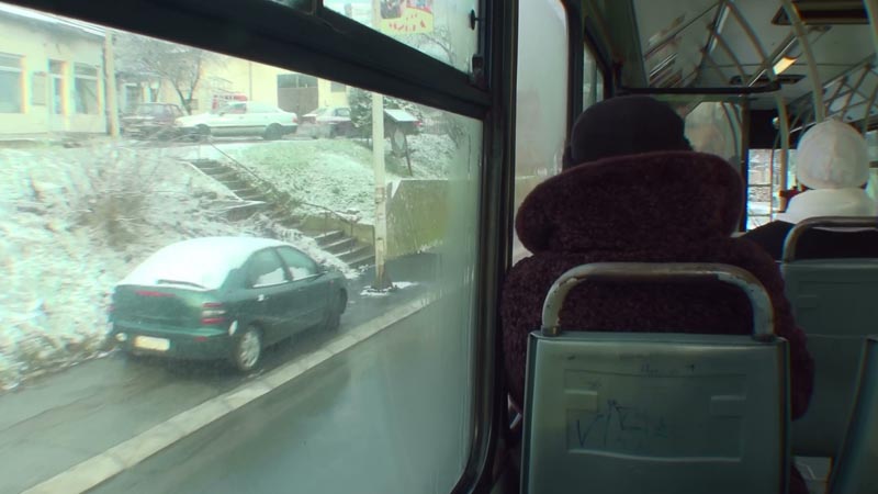

the green thing may be disregarded due to WA adapter, and the grass was green so in the motion it is a bit sluggish, but the whole picture is a bit tinted. on the second it is going blue due to CromaAberrations.
so, that probably is not the camera fault.

With PMB, there's a big red "X" in the toolbar - that deletes media files, and you can right click, the options are on an extensive menu. When in the preview window, again the big red "X" does the trick.
If you've got CA from a bad WA, that's not the WB, bad glass is bad glass... and I've seen some really bad WA's. About the best is the Sony HG0737Y IF you can find one. Big, heavy, and very very crisp, the earlier and later HG lenses are smaller and lighter, but you'll see a few quibbling points with the image...
On the three images, the third one is probably center weighting in action, the other two puzzle me, as the cam SHOULD be focusing on the center of the frame, right where the subject is. I'm not sure why switching to spot focus and pointing at the specific spot on the screen you want in focus isn't working, these are the exact type of shots where I've found that function to work well...
ONE possibility is if you're tele'd in too far, you may simply be outside the range where the camera lens can resolve focus - that's a distinct possibility with those first two shots, and it will TRY to focus, but not be able to shift to the closer plane, and it WILL keep trying. You may need to spend some time getting a feel for the focal range and where it can and can't focus. If you're zoomed in, and try to get close to a subject, it can get iffy.
You mention shaking a Canon to reset focus... with Sony, a crash zoom out and back in is more effective <wink>! Forgot about that trick, might help you! Every camera has it's quirks!

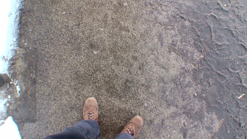

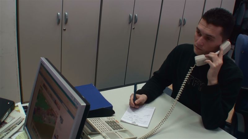

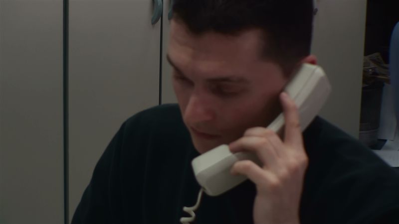

maybe i`v got a lemon, but the main subject is unfocusable for me. and it is really making me mad, since i can`t relay when shooting on this cam. but i will have to live in not so happy marriage, since i can`t return it. thus this is ending any kind of my sony experience :(, so i have to stop veining and start working with my not so smart cam
i have uploaded some more examples, there is no way to focus on first subject in the shot.
clearly seen on the guy with the telephone (pic n3 - the wardrobe is in he fokus also), i have start zooming and grrr (pic n1), the back is my sony favorite. then to zoom gymnastics and a bit closer shot of the same guy (picn n2), and the focus is Ok. that kind of gymnastic discredit this camera even for the family snap shots - since wardrobe and wall will be only sharp thing on the birthday party :)
even on the broad day light, cops are unshrap, and the back is. i wish i win the lottery and break this camera in peaces for the you tube :)

- PMB, the delete button X is only for deleting the movies on the PC HDD, not on my camera, but i would like after importing do delete all camera footage from PMB if possible. so i don`t have to bother in the camera. on the import screen i cant find anything of that kind?

Ok, let's start with the easy part - PMB. When importing (first screen that pops up when you connect the cam), there's a button for settings, and you can check or uncheck a box for "delete clips from camera after importing" or something to that effect - it's in the same area where you select your target folders. You can also delete from in camera if you left clips on, as it will only detect and delete NEW clips I think. With the in cam delete menu it's pretty fast and you can select all...
In the third pic, the center of the frame IS the background, and that's where the cam will focus unless you use spot focus on the guy on the phone. That's a "center weighted focus". Spot focus overrides that, and is about the only effective way to do it.
NOW... about that WA lens... I'm presuming you're leaving this lens fitted when all the focal problems are occurring? I can see it look relatively sharp in the center, but looking soft(er) as it goes out to the edges - VERY typical cheap lens "performance". may be almost OK in the center, and gets worse as you go out... even more of a problem with a 16:9 image.
You're talking about a lens that's probably retail around $50 US... I've got some here, I actually keep them around for the odd optical distortions, in case I want that effect...
The Sony HG0737Y when issued was nearly $300 (it was designed for the HC1, which was a 2K camera), even the current HG (High Grade) Sony lens is around $200 IIRC, and I've got several versions of the HG0737 - ONLY the Y makes the grade IMO, but it's too darn heavy to drag around, so I usually keep a "C" version handy, and live with a little less image quality.
What I'm geting at is if you're putting cheap glass on an expensive camera and blaming the camera for the issues which arise, you're looking in the wrong place. Cheap glass is cheap glass. When it comes to optics "you get what you pay for".
I understand the desire for a wider field of view (Sony evidently does too, as the cams released later this year have a "WA" field), but I've seen how badly a cheap WA degrades the image on an HD camera, and it's simply unacceptable. I don't know how Sony's current WA compares (HGA07), to me the HG0737C is barely acceptable, but it's way better than the cheap stuff.
I understand your frustration, but myself and many others have and use this cam to excellent results, so unless you have a lemon (which I'm beginning to doubt), you need to look at your whole system before writing off the camera or Sony...
What I'm seeing is "normal" operation and indications of a cheap WA add on lens.
