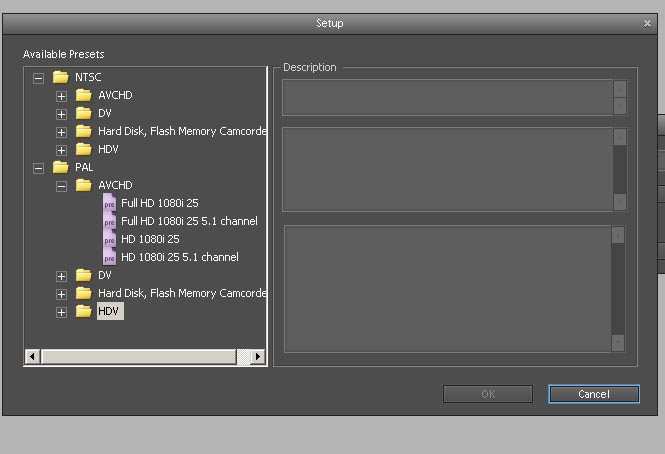

premiere elements 8 has a full avchd support, so for that matter i think it would use the same algorithms as ppCS4, you have a free trial of PE8, so you can try it and see how you are comfortable, but as noticed in upper post, you would have to upgrade to quad qore, i think. or maybe pure speed of your 3ghz dual core is enough, but i doubt.
