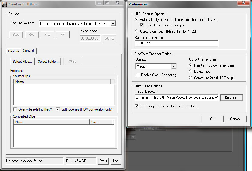

Thanks for the post Robert. Sorry for the delay in replying - have been away from my PC for the last week. I was just about to go through my whole workflow and post screen grab of all my settings. I'm starting to think however that it may be a problem with my cineform AVI files.
Below are the settings i used in Neo Scene to convert the .m2ts files from my XR500E.
http://www.dvinfo.net/forum/attachme...i_settings.jpg

You need to check and see if Neoscene offers the 1920x1080 format. Originally Neoscene was a product for HDV use and as such only offered 1440x1080 resolution. If Neoscene is actually converting your 1920 AVCHD to 1440 1.3 par CF.avi, then you need to use those specs for your CF sequence in Premiere. And, I might add, the final image quality wil not be as good as if you had been able to maintain 1920 rez throughout the workflow.
Deinterlacing, or changing frame rate to 24 should not be necessary, or a factor affecting your final result. Previewing high data rate interlaced footage (like CF.avi) on a natively progressive system like a computer can cause some motion artifacts that are simply "previewing artifacts" and are not a reflection of the quality and integrity of your footage files.

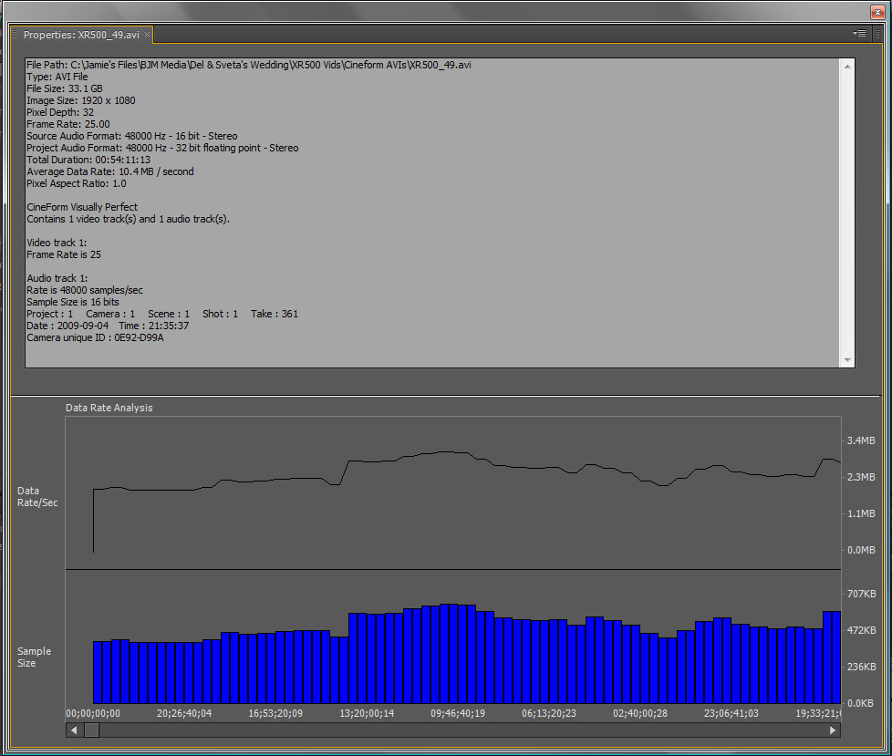

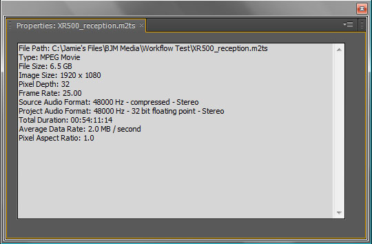

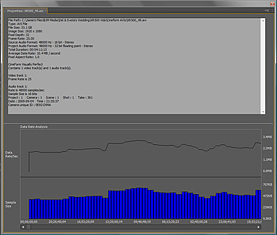

I've checked the neoscene specs (at http://www.cineform.com/neoscene/features.php) and it does appear to support full 1920x1080 format files. When i import the cineform avi files into a project in premiere, i checked their size by right clicking on them and selecting 'Properties' - i've attached the results for the cineform avi files and the raw .m2ts. Assuming i can trust premiere's interpretation of the files then the cineform files have retained the 1920x1080 size.

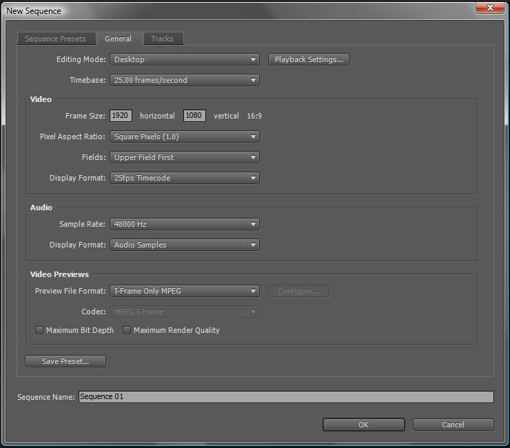

To follow your suggestion, i created a new sequence with the settings in the attached image. When i put the .m2ts file on the timeline i don't get a red bar above the file which i assume means that the sequence settings match the file properties. When i put the cineform avi on a yellow bar appears above it, which from what i understand is what you'd expect to see. I trimmed the files, added a few transitions then sent the timeline to a standard dvd encore project and burned it to a standard dvd (i'm waiting for some new blank blu rays to get delivered!) using the automatic settings.
When i watch the dvd through my Sony LCD HD TV, the .m2ts files look perfect - nice smooth motion, no problems at all. Then when the cineform avi files play i get the jerky motion. So it definitely seems to be something about the cineform files that is causing the problem. But from the checks i've performed there doesn't seem to be any difference in the size, frame rate or field order of the 2 files.
There must be some difference in the files that is causing the 'jerky' motion problem with the cineform files though. Is there anything else that i can check/try?

A couple of observations:
Cineform HD interlaced .avi to DVD is a tricker animal than going to Blu Ray.
Excellent Blu Ray is a straight shot from CFHD timeline> export to AME BR codec> burn to BD
My workflow for the best 60i DVD is 1920x1080 60i CF.avi> export to a Cineform SD 720x480 60i CF.avi> transcode to m2v from the SD "master" .avi file
If the HD CF.avi is progressive, then you can skip the step of exporting to a SD CF .avi, and just like with Blu Ray, it's a straight shot to export from CFHD 30p .avi to DVD m2v> burn to DVD.
Take your handfull of AVCHD clips and have Neoscene deinterlace them as CFHD 30p (25p) .avi, put them on a PPro CF 1920 25p sequence> export to AME m2v>burn DVD and see if that looks as it should.
If it does, then you know you have an issue with the AME downscaling of your HD interlaced footage (a known issue with AME and CFHD 60i), and you'll need to make the CFSD .avi intermediate file, and code to DVD from that.
I tend to maintain my acquisition parameters throughout the workflow- if I shoot AVCHD 60i, I will remain in 60i until a change is necessary- ex: web delivery (30p). If I shoot 30p I will stay there until the end- ex: BR 1920 60i.
However, there are many who will routinely deinterlace 60i acquired footage on ingest, and use a 30p workflow throughout. Cineform HD Link does a great job (much better than PPro/AME) of deinterlacing the 60i AVCHD to 30p CFHD.avi.
Bottom line, you need to explore all of these alternatives and decide what works best and looks best to you.
Bob
