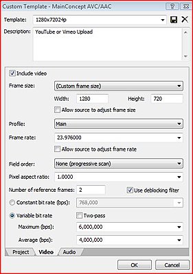

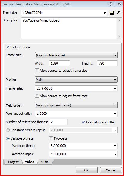

Try the MainConcept AVCHD (mp4). See settings below. Depending on frame rate shot, change from 23.97 to 29.97

AVDHD MP4 just crashes, all other AVCHD types work fine but MP4 crashes. And why can't I maintain a 24P look onto youtube?
