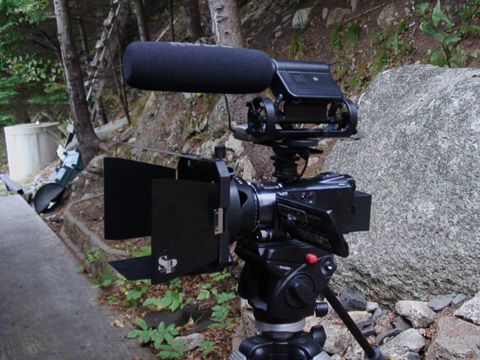

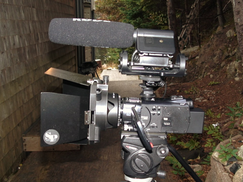

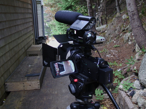

How can anybody be taken seriously if you show up with an itsy bitsy camera like the cx550?
So change the perception for a couple of dollars!
this is my tricked out cx550v now it looks like an uber camera too

Hi Bruce,
Sorry I missed your post yesterday, but everybody’s celebrating Rosh Hashanah down here and I’m barely holding up.
Looking at your pictures I only can say: Wow!
But that is to say, to dress the camera like this costs more than a couple of dollars, isn’t it?
I can recognize some expensive pieces of your dressing: Manfrotto tripod fluid head, Rode VideoMic, matt box...; all in all it’s close to three hundred bucks, right?
By the way, why do you need the matt box?
P.S. Happy Hebrew New Year to you!

Hey thanks for the Happy Hebrew New Year Arkady. Sounds like your celebrations were 'over the top'.
The half decent video head is of course de rigeur regardless of camera but If I may say the cx550v is simply amazing in its ability to smooth out hand held footage. I filmed my son at a skateboard contest and the resulting footage really astounded me. I'm definitely old school when it comes to tripod use for paying video gigs. Cameras are on video heads period but my boy wanted a low key recording as not to put him under more pressure so I handheld and it's beautiful, sort of floats along without the usual jarring associated with hand held shots and for several hours. Sony has done a beautiful job in the stabilization protocol on this camera.
Not In the pix is a 3 input passive microphone mixer (azden) mixing the audio from the shotgun and a wireless unit.
The matte box is for effect only. In fact it is a cheap barndoor set on a tulip lens hood which is mounted on a 37 - 52mm step up adapter and screwed into the lens
the video from this camera seems better than my FX7 and certainly superior to my HC1s
This rig simultaneously records hd-mpeg4 to it's internal memory and mpeg2 thru the s-video port to an attached DVD recorder and when I push the photo button, it records an 8megapixel still to the pro-duo flash memory card. Quite a feat for such an itsy bitsy camera. No other that I know of will do the three outputs as beautifully and at the same time.
It uses the same sensor as your AX2000 albeit just a single.
Dave -stealth mode by undressing the rig
