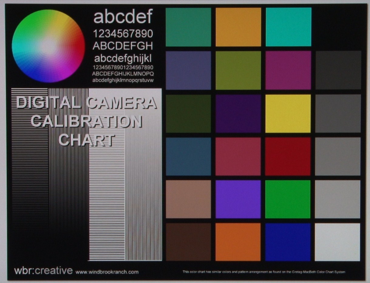

Please observe the results I have got experimenting with xvYCC. I recorded a Munsell ColorChecker Card (see the first attachment) in sRGB and xvYCC color spaces; then I cut colored squares from the frames of the recorded footage and put them together (for the purpose of comparison) so that each xvYCC square would partially overlap the corresponding sRGB square (see the second attachment).
Look closely: you may see that the difference between extended- and standard-gamut color spaces is real, and it is manifested chiefly in the pairs of yellow, green, cyan, and violet squares.
