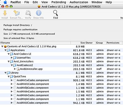

I think you are right Nate. I opened the installer package and it looks like all it does is install the Avid quicktime components in the root library.
I think it is important to move these components out of the root Library and put them into the User Library. That way they won't cause any conflict during startup.
I've since done some trial and error testing and it appears the only component that causes a conflict during startup is AvidAVUICodec.component.
The rest work just fine with compressor and seem to add support for:
Avid 1:1x (AvidAV1xCodec.component)
Avid D100 (AvidAVd1Codec.component)
Avid DNxHD (AvidAVdnCodec.component)
Avid DV (AvidAVdvCodec.component)
Avid Packed (AvidAVpkCodec.component)
Avid Meridian (AvidAVDJCodec.component)
The original AvidAVUICodec.component was part of the Meridian codecs paired with AvidAVDJCodec.component for ABVB systems, but it doesn't seem to be required anymore. Very odd.
Now, what works with FCP 5.1.2????
Everything except Avid D100 codec (AvidAVd1Codec.component) and the AvidAVUICodec.component.
So, if want to use Avid codecs with FCP 5.1.2, just install them, trash AvidAVd1Codec.component and AvidAVUICodec.component, then move the remaining components from Macintosh HD/Library/Quicktime to Users/User name/Library/Quicktime.
