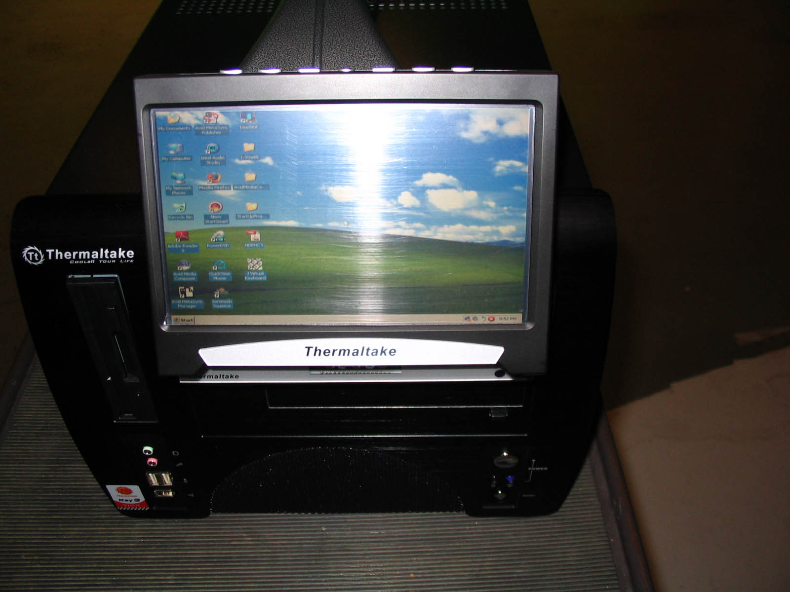

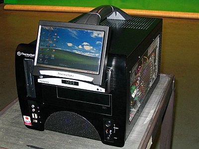

Just wanted to post up some pics of my Portable Intensity Capture Station.
I am running it through some paces, but do plan to make them available to interested parties.
One thing I have tried is to capture Uncompressed, Blackmagic Motion Jpeg compressed, and Cineform Compressed clips with the capture station. From there I imported into After Effects and then exported to Quicktime with the Avid DNxHD codec. It really isn't too slow of an export. You must have Avid Media Composer installed to have access to the DNxHD 220 resolution. Once the file is done exporting out of After Effects, fire up the Avid and import. It works great if you just have to edit in the Avid and don't mind the extra time in the transcode.
Here are the specs
Portable Case w/ handle
Silent Power Supply 500 Watt
Micro ATX Motherboard (Intel)
Intel Core 2 E6600 2.4 Ghz
Geforce 8500
Processor Cooler
2 Gig Ram
DVD Burner
2 500 Gig Seagate Drives
Intensity HDMI Capture
Keyboard / Mouse
Win XP Pro SP2
7 Inch LCD
Let me know if you have any questions.
Which Flavor of DNxHD Truly Visually Lossless?-camera.jpg   Which Flavor of DNxHD Truly Visually Lossless?-capture.jpg
Chris Swartz is offline   Reply With Quote

That's pretty nifty. Sort of an HDMI low cost version of a Wafian Recorder. I think this works great if you're going to edit in BMagic or Cineform codecs.
But if one insists on editing in Avid, what is the advantage over going in HDV Firewire other than 4:2:0 vs. 4:2:2??
HDMI>to Cineform Codec>AFX>QTDNXHD>Avid MC (Seems like you loose the advantage of 4:2:2 by this point by transcoding, twice??) And again when you're ready to output/export.
Firewire>HDV DNXHD 110 (Native HDV Smart Splicing No transcoding during edit.) Direct digitize.
I think Cineform Neo would take a step out of the process allowing transcode into QT DNXHD w/o having to go into AFX.
I'm not trying to diss your solution here and more and more people are using HDMI. I think Adobe PPro works better in this case because you can edit in Cineform codec and cuts time/transcoding.(Just my opinion) It just highlights how proprietary Avid operates.
But cool tool anyway.
