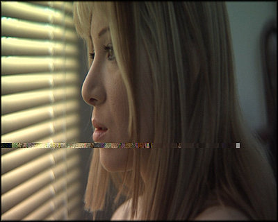

Hello all...
I'm getting image corruption when rendering real time effects applied to the timeline layer. I've attached an image that shows the corruption. Has anyone seen this type of problem in rendering? The clip plays fine in RT unrendered...it's just when you go to render that the problems begin. The effect was an 180 degree rotation, but I tested with other effect and saw the same results.

What video card and driver do you have on that system? This is usually a problem in Liquid with certain video card drivers or a video card itself.
The card is ATI GLFire x7300 with driver 8.353.1.1000

Try the driver version 8.223. This is the last certified driver to work with Chrome XE.
