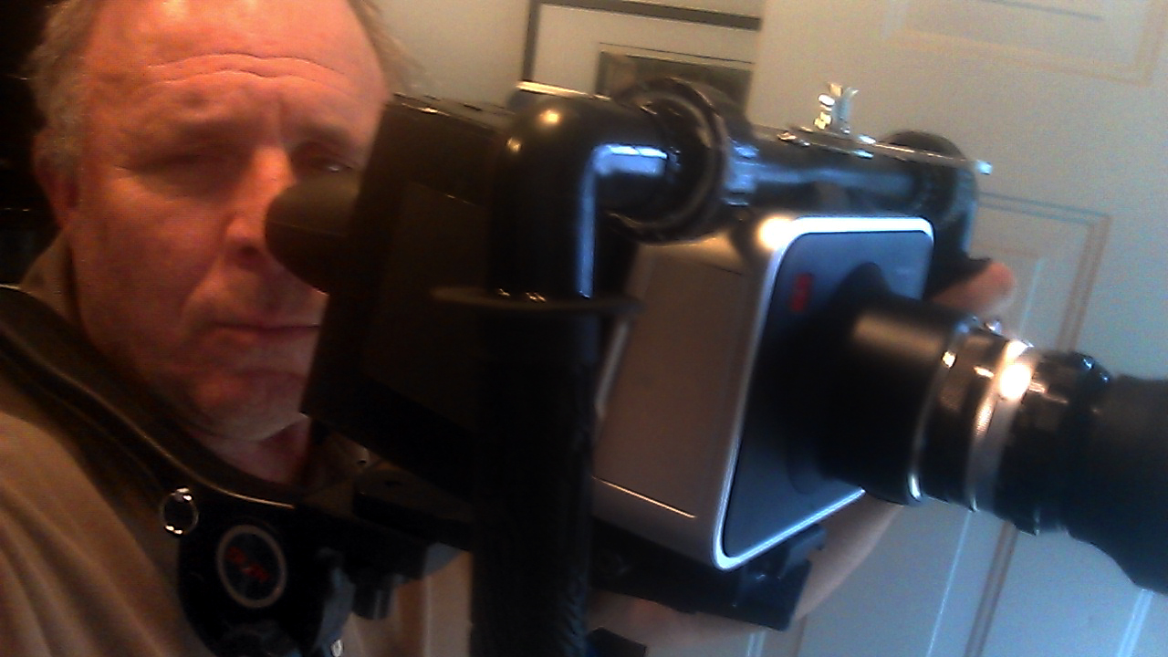

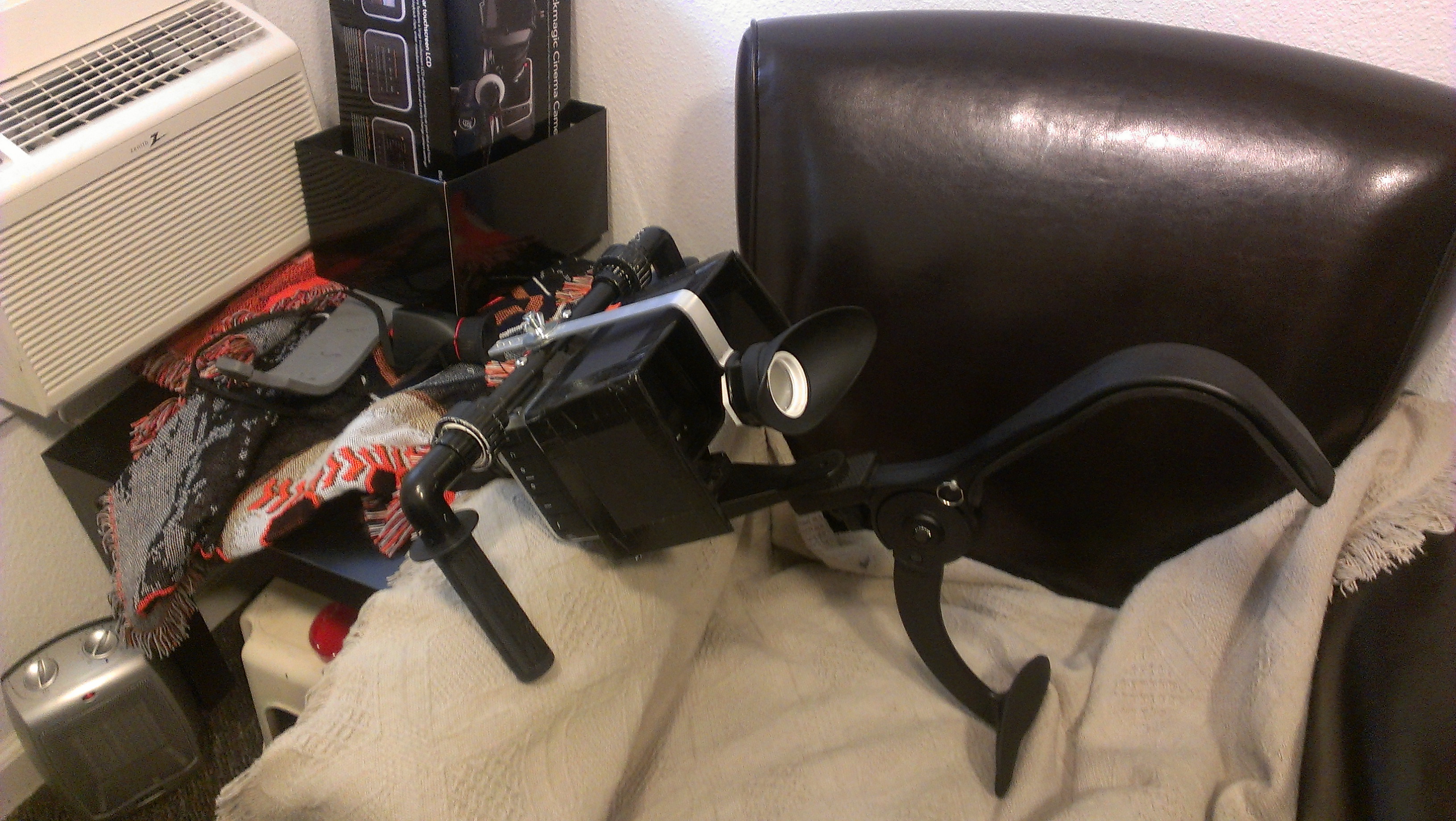

Next thing that became clear was in hand held and run and gun situations, I knew I was going to have to do some sort of shoulder mount thing. The camera is a lot heavier than even my 5D Mark II, and for long shoots, it was clear it was going to need some sort of support.
The first thing I tried was the shoulder mounts I had built form my DSLR's aand adapted to my VG20. In some respects, they were satisfactory. But I could tell, that in day long shoots, there was going to be a real problem, as set ups put all the weight forward on my hands and wrists. It was also clear that center of balance was making the camera tip back and forth more on that kind of a set up.

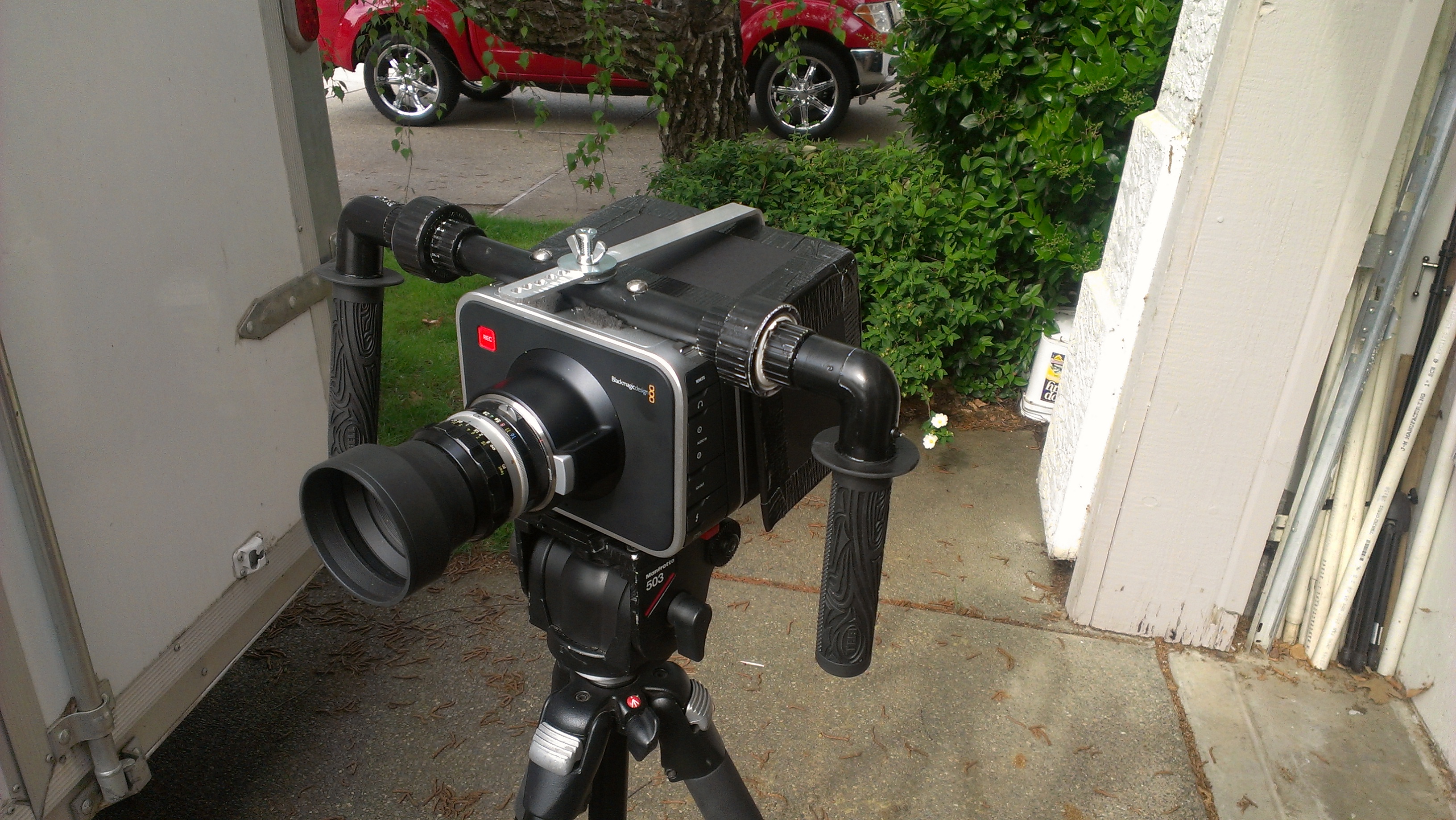

I remembered Black Magic was marketing a two handle bar that bolted on to top of the camera. I gathered together about $ 15 in parts and paint, Set about making an adjustable set of hand grips to bolt on. I added that to the $ 26.00 shoulder support I had on the top shelf gathering dust. (It is now sold under Cowboy brand name, and others, as I recall.)

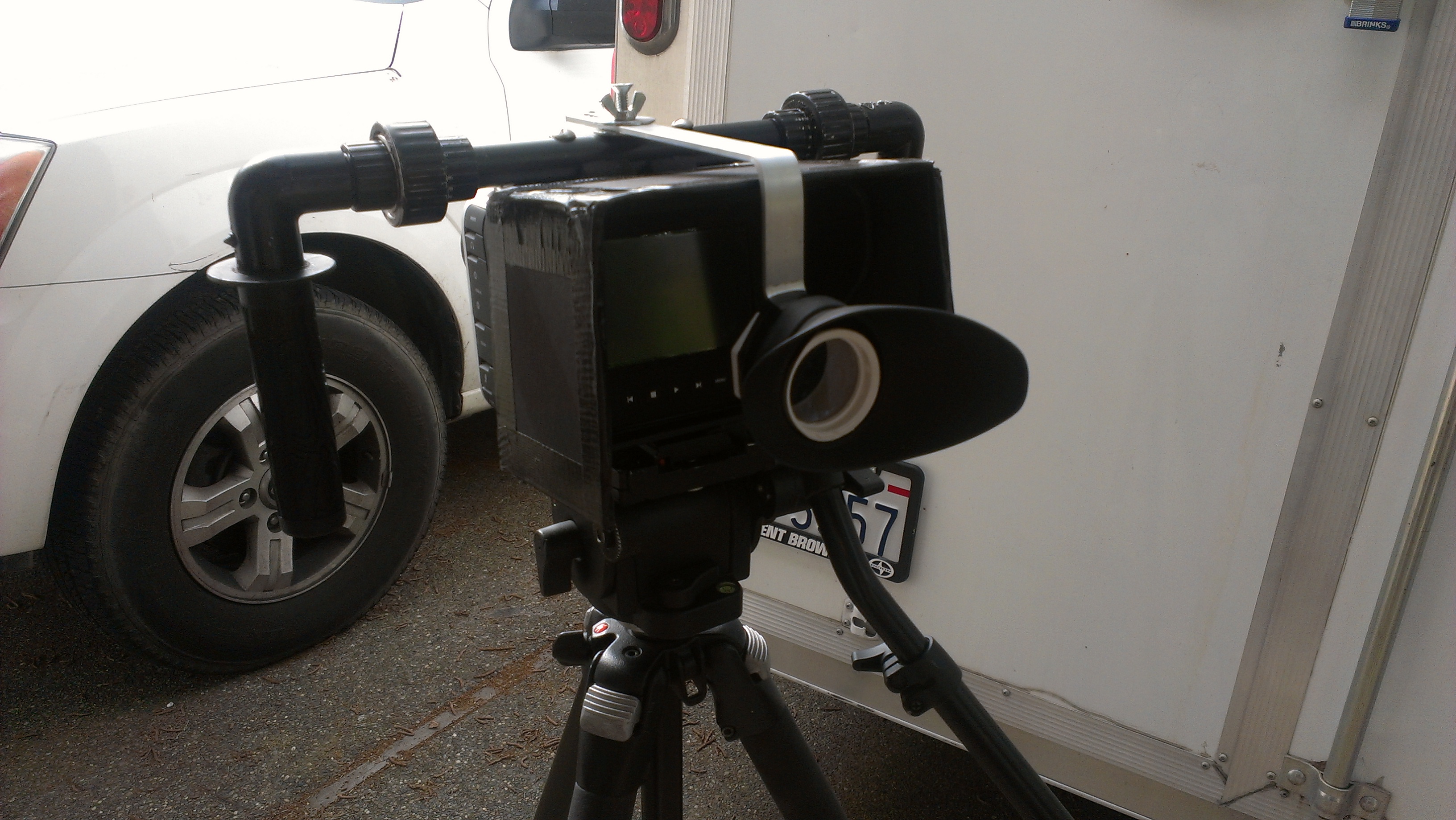

Another $10 materials netted me a magnified eye piece that I could use for critical focus. That resulted in a determination that I needed more that just the hood provided by Black Magic just to keep extraneous light off the LCD. So from black poster board, I made a larger hood that extends from the provided hood.
That hood will probably need further modifiction as light still spills in from behind the shooter. I am thinking a small cloth curtain will probably handle that.
I've attached photos below just to show you this project started out, and I will update as I add other things like the microphone and my Juiced Link XLR adapter.
