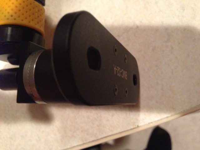

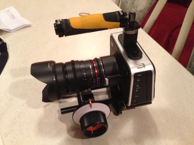

I bought an Ikan setup for my BMCC and was overjoyed when it arrived this week.
But, to my shock and horror (ok, maybe not horror, but still), when I took off the handle to put it all back in it's case, the top of my brand new camera had dents in it from the screws on the bottom of the handle.
Couldn't they have counter-sunk them just a little to avoid damaging a brand-spankin-new camera?
/Ticked off.

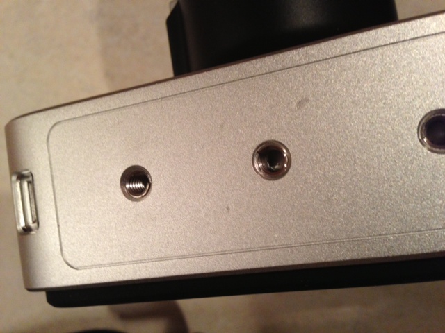

Have you screwed a quick release plate to it yet? That leaves marks as well... as near as I can tell, the metal on the bottom of the BMCC marks EXCEPTIONALLY easily...

I did put the Ikan baseplate on the bottom, but I haven't checked for marks from that. Now I'm going to go check...
The regular tripod plates don't leave marks or dents.

The one I use (I'm not an owner) is already heavily scored on the bottom from mounting plates on Manfrotto tripods in a ring pattern.

Here's Ikan's reply:
Judging from your photos, it appears the normal wear and tear that occurs on the aluminum body of the black magic camera.
We have a few of these cameras in our possession, and when we attached anything that is metal(Ikan and non Ikan products), it usually leaves a few scratches/marks.
We’ll still be happy to provide refund for your Ikan purchase, but since this isn’t a fault of the ELE-BMC-HDL, we will have to charge a 15% restocking.

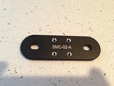

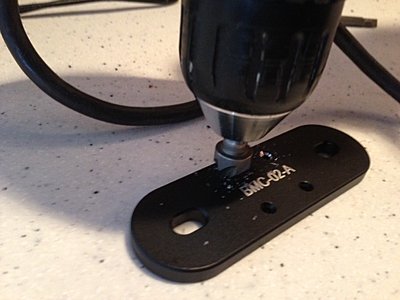

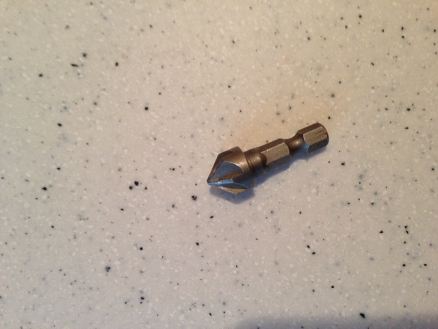

Fixed it myself.
Just needed to drill out a bit more room for the screws to REALLY be countersunk.
"Ikan: Fix it yourself!*"
*or a 15% restocking fee.
