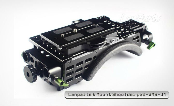

Lanparte V mount camera support systems shoulder pad baseplate
This base plate/shoulder mount would allow ergonomic control over camera and lens in a traditional ENG style. A 3rd party EVF will be necessary to go off tripod with a rig with this base but as Alister says, the issue is avoiding fatigue on your arms. Also, focus with an EVF is much easier, more accurate, and more flexible in terms of positioning. The onboard veiwfinder, while I don't believe it would be adequate for focusing, would still useful for settings and framing.
