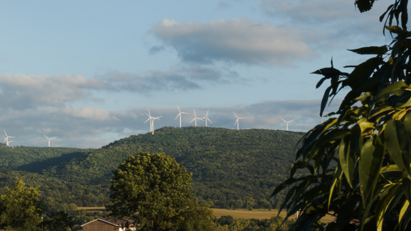

I've started playing with my BMPCC, and am wondering why my RAW video looks so good right out of the camera. From every review and sample video I've seen, RAW video should look flat and washed out, but my RAW video has a very saturated look to it. I'm in "film" mode (no option for video in RAW) . I've attached a JPG sample.
Format is RAW, 200ASA, 30 FPS, 180 degree shutter angle. Firmware is up to date. Using a cheap panasonic lens for testing purposes. What am I doing wrong?

I get 45-60 minutes per battery. Not great but not pathetic at all.
That's doesn't look like original Raw to me. Yes I have the camera.
The word "look" is key. Looking obviously involves using something and maybe that something is adding a LUT of some sort.

Raw is different than log. Log footage is what you would expect to be flat and washed out. Raw would have to be looked at with a LUT applied so maybe you are looking at Raw with a look applied,

Yes that looks like Raw with a LUT added.
When asking about what one is seeing it's good to provide information about how one is viewing the files.
Raw doesn't have to have a LUT added. One can certainly view Raw without LUT just as one can view ProRes without LUT if it was shot in Film mode.

Sorry, the still was pulled from Resolve Lite 11. When I right click on it, it says no LUT (there are options to add them).

Resolve gives you a lot of options for dealing with raw. If you go into the raw tab (looks like a camera icon on the color page), you can select how you want Resolve to process your raw footage. "Camera Metadata" gives you the look closest to what you saw in camera, while "Clip" combined with "BMD Film" Color Space and Gamma gives you a flat profile, like you would expect from ProRes. You can also apply Rec709 color space and gamma, which is quite useful if you just want a quick normal look for your footage (not everything has to be color corrected).

As long as you don't change it by hand, raw material is automatically debayered in 709.
In the color tab on the left side there is your raw settings (the tab with the camera on it).
Set it to "BMC film" instead of "709" and there you have your flat look, where you can add a LUT to it.
