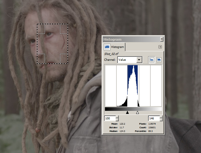

Old March 23rd, 2015, 01:01 PM   #7
Location: Efland NC, USA
Posts: 2,322
Re: BMPCC 3D LUT appear overexposed
Here is what I measure.
http://www.LandYachtMedia.com

Thanks for your guidance. I will get a screen shot for you this evening.
Frank Grygier is offline   Reply With Quote
Old March 24th, 2015, 01:24 PM   #9
Location: Austin,TX
Posts: 125
So skin tones are about middle grey?
No, they should be around 60IRE.
Old March 24th, 2015, 09:11 PM   #11
Location: Austin,TX
Posts: 125
Got it.
Thanks for putting me on the right track.
