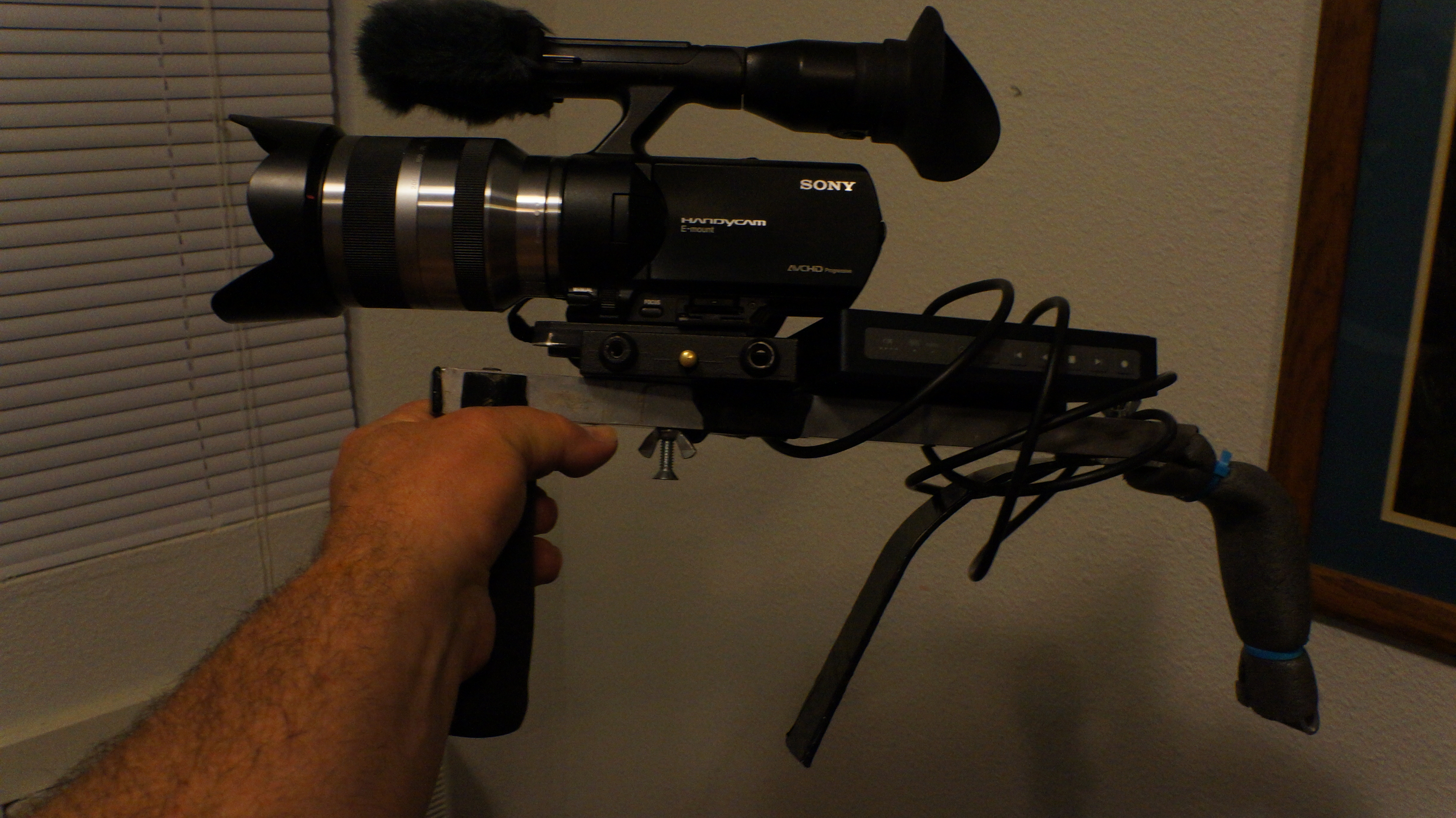

I build most of my own stuff anyway, and with my 'VG20 and or HV30, I actually have a shoulder mount that made. that I have just added a strip of Velcro to and to the back of Shuttle Hyperdeck. Ugly but it actually works quite well. See photo below.

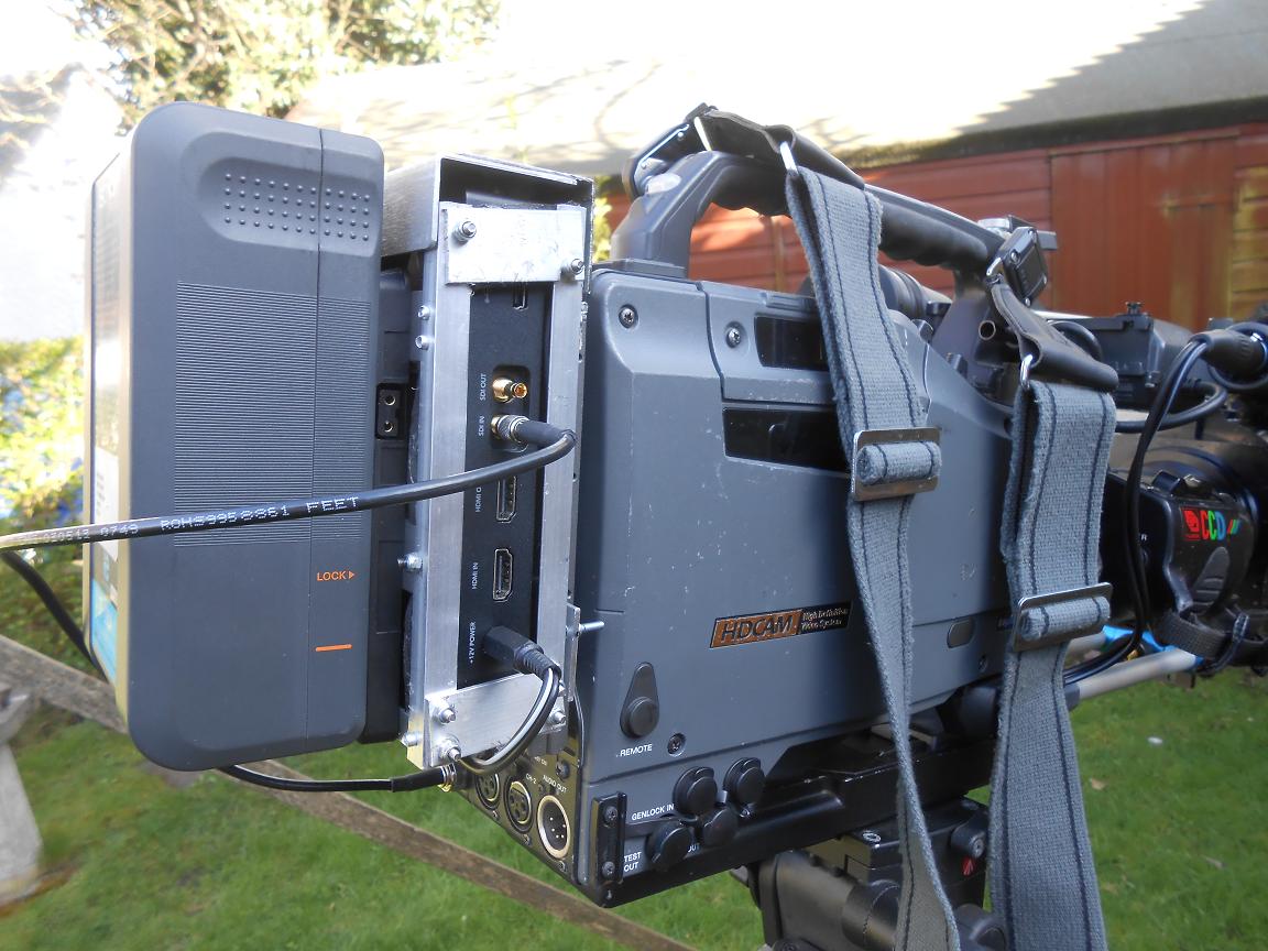

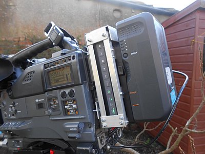

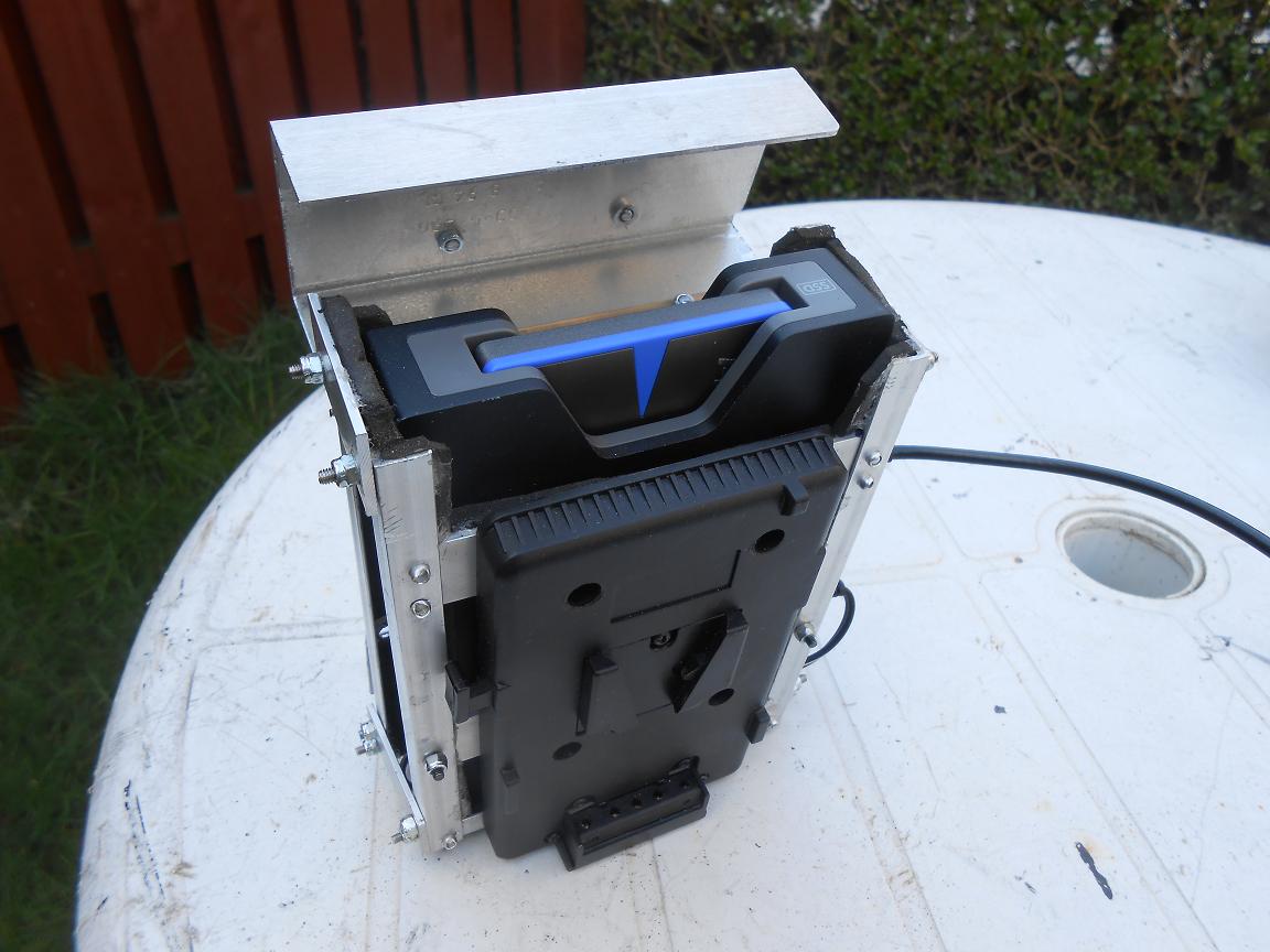

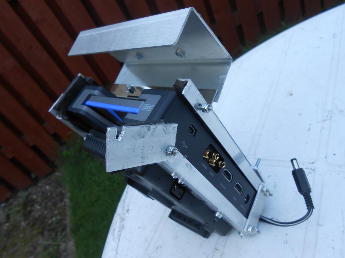

I have made this cradle for my HDW-750P, and it will fit any v-mount battery camera or accessory.
I lined it with some rubber matting I got as packing with a laptop lithium power supply so it is nicely shielded from vibration.
My one regret is that I have to unclip it from the camera to remove the SSD so if I was to make another I would hinge the lid on the other side. In a way it prevents anyone nicking the SSD I suppose.
If anyone has any questions I would be pleased to answer them.
