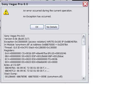

BluRay Burning Fails Immediately in Vegas 8.0b
As soon as I hit enter to burn a bluray in V8 I get back an immediate error failure message. This is an HDV to BluRay on a DVD+R DL Mpeg 4.
My computer is a 2 year old AMD Athalon X2-4200 dual core with 2 g of ram. I have 2 IDE drives, 1 - just for Win XP system and office, the second I keep Vegas, Premiere and Cineform on, and my 3rd drive is a Sata Raid (4x250g drives) for capture and encoding. I also upgrade to Cineform Prospect from Aspect. Now however I see they have raised the minimum system to a quad core E6700, which at this time is pretty much state of the art. The file I am trying to burn was captured and 99.9% edited on V6 with Cineform Aspect. This file seems to play and edit just fine in V8. Is it likely that my computer just doesn't have the moxy for Mpeg4 ? Or do I have a software issue.
The above system works fine with Ulead MovieFactory to HDDVD. However these were Mpeg-2 files. In MF6 you can play with the encoding and I used VBR to get the project to fit on a DL disc.
I would try the V8 bluRay to Mpeg-2, but its doesn't allow you to adjust the bit rate when your at the Tools\Burn\BluRay prompt. The default is too high for my project to fit on the disk. Anyone else having this problem? I see many have issues with it failing at the end of the encoding process, but mine has a failure as soon as I hit burn. Thanks for any help - PK

What's the error message? Click on the "Details" button and you can copy/paste it - assuming that the machine hasn't locked up.

Attached is an image of the error message. I confess, I have no idea how to read or understand what these messages mean. This is an "exception" error. Exception to what? Then theres just a bunch of what look like memorey locations along with "stack dump." The complete message scrolls down and would take 3-4 images to cover. If that helps, I'll be happy to try it again and record the entire message. Thank you very much for taking the time to look at this. Sincerely - PK

Paul, I'm not positive, but you might have a bad memory location. You could install and run Prime95 overnight to check if your hardware is healthy.

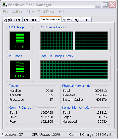

Attached are screen shots from Task Manager as Prime Number runs. It shows CPU at 100% and about 1,5g of memory bbeing used (I have 2g of ram). I used the "blending" test to test both cpu and memory. Are these the correct settings? Its been going for almost 2 hours now, and I am still able to run other things, like a downloaded video clip from email, etc. If this was really pushing both of the dual core CPU's, would I still be able to do these things while the test runs? Thanks - Paul

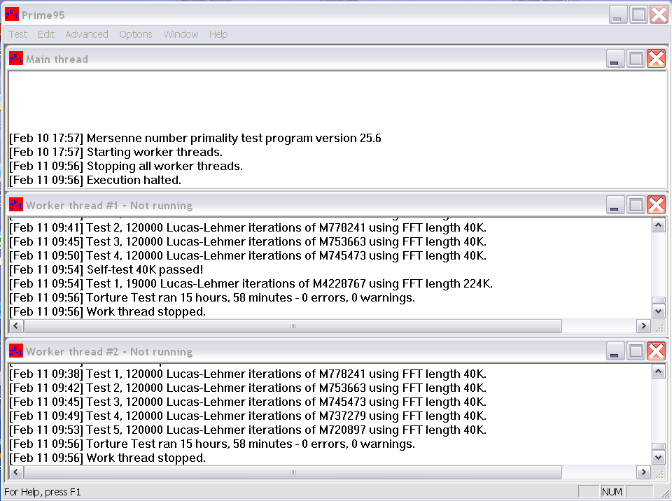

Jon, attatched is a copy of the Prime Number Test results. I'm not sure I had it set up right, as it only was using 1 cpu. I tried setting it to 2, but it said that was more then I had. This could be semantics - as it did sense that my cpu was a AMD X2 4200 dual core (vs 2 separate cpu's). It did keep running memory location tests for almost 16 hours and never had any errors.

Paul, the results look good. This confirms that your RAM is running without errors.
