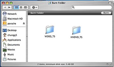

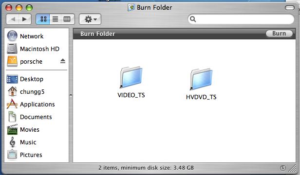

Update #2
Ah ha! I've solved the issue with DVD Studio Pro and making HD-DVDs that work with the Toshiba's with New Firmware 2.0. [Basically the same hint that PC users do...]
And you've heard it first here! Even the Apple forums don't have this answer yet..
Basically here is what you need:
Create a "Burn Folder" in Tiger.
Inside this folder, create a VIDEO_TS folder which contains a plain text file that is named "VIDEO_TS.VOB"
Place the "HVDVD_TS" folder[that you created when you authored a DVD Studio Pro HD-DVD, alongside the VIDEO_TS folder in the "Burn Folder"
Burn the DVD.
Voila! DVD Studio Pro does not include the necessary "VIDEO_TS" folder...that is why the 2.0 firmware Toshiba will not play the DVD Studio Pro Authored discs.
Follow basically the same instructions for HDDVD making as how the PC users do it in the AVS forum thread.
HD content burned onto a standard DVD playable with either HD-DVD or Blu-Ray Players?-directory.jpg
John C. Chu is offline   Reply With Quote

I actually had the same issue, 2.0 broke my A1, it used to play all of my +R's just fine and now it won't I have cused and B*&^ and nothing. (BTW: They don't support +R, but mine played them fine until 2.0)
Last night playing with a couple of settings and things I decided to try instead of burning directly from DVDSP to just create the folder and burn it using Toast 7.
IT WORKED, no need for VIDEO_TS at least for me.
Toast 7 or 8: Create a new data DVD in UDF format, and put your HDDVD_TS folder in it, that's it.
The problem has been DVDSP all along, no useful menu's and such.
NOTE: Whatever the success or not, something changed radically on the 2.0 firmware that screwed us all up.
I have heard of reports of people having success with H264 and DVDSP4 menu's but that's about it "Rummors" have not seen actual posts explaining the process.
Good info---I guess it is because burning from the finder in Mac OSX 10.4 is automatically utilizes a UDF format...and DVDSP4 is not doing that correctly for the 2.0 firmware.
