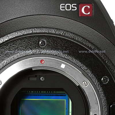

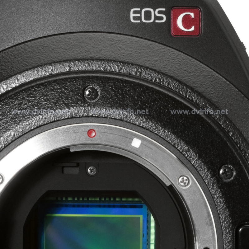

Posts: 27,382
Re: C300 and still lenses compatibility
The answer is yes, the C300 is compatible with EF-S lenses, and there's even the little white square EF-S mounting guide on the face of the EF lens mount.
See attached pic -- hope this helps,
